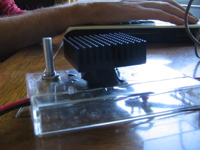

I had a question about heat: when running, the little thing gets pretty warm -- on the edge of me being able to hold my fingers to it. I have attached a heat sink (see attached pic). The NTE970 that I'm using (the "equivalent" of the LM150) is spec'ed at:
Absolute Maximum Ratings:
Operating Junction Temperature Range, TJ . . . .. . 0° to +125°C
Storage Temperature Range, Tstg . . . . . . . . . . . –65° to +150°C
Thermal Resistance, Junction–to–Case, RthJC . . . . . . . . 2.5°C/W
...although I'm not 100% of the implications, 125°C seems well above the temperature it's reaching, so I assume I'm well in the clear? I just want to make sure I don't ruin another one of these. :)

P.s. the picture was taken by the camera being powered by the fake dowel-rod batteries from the unit. :)

The max allowed internal chip temperature is 125 degrees c. The case is probably much cooler.
The thermal resistance shows how hot its case is allowed to be at the power it is dissipating.
Hmmm... thanks, so, if I have this right:
I have 18.5 V into the thing, output to 3 V, so:
(18.5V - 3V) * 1A = 15.5W
(assuming 1A for the digital camera, which I'd guess is a fair overestimation)...
But I'm not sure how to interpret "2.5 deg C / W"?
I can also just use a lower-voltage power supply...

You have the regulator dissipating 15.5W. Its chip to case heats with 2.5 degrees C above the ambient temperature for each Watt that it dissipates. So with an ambient of 30 degrees C, the minimum thermal resistance of a heatsink is (125 - 30)/(15.5 x 2.5)= 2.45 degrees per Watt. Select a heatsink with a thermal resistance of 1.5 degrees per Watt. It will be pretty big.
audioguru: did you mean 2.5 degrees / watt? Anyway, I changed out to a 5V DC adapter so now it's cool as a cucumber. I can let go of the lesson in thermodynamics, i suppose. :)
