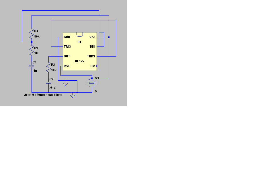

I decided to give this software a try again.
have a simple 555 connected as a triangle wave output.
hit simulate and move the red probe over pin 3 but get no wave.
must be doing something wrong.
is there a website that has a tutorial or ??
this looks better than multisim. not as easy as Tina but Tina has limited components
any help??
The discharge pin is misconnected. Connect it to the junction of R1 and R3; not to +6V!
I think you also need to have a ground pin at the negative ternimal of the battery.
getting somewhere but ??
added the ground and changed the dis pin (that was a really dumb moves on my part) and now getting a partial triangle wave.
possable to get the full wave?

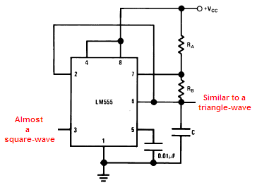

Why don't you look at the datasheet of a 555 to see that yours is connected completely wrong?
The Trigger and Threshold pins must be connected to the timing capacitor.
If the resistors are the correct ratio then the pin 3 output is almost a square-wave.
The timing capacitor has a curved waveform similar to a triangle wave and is a high impedance.

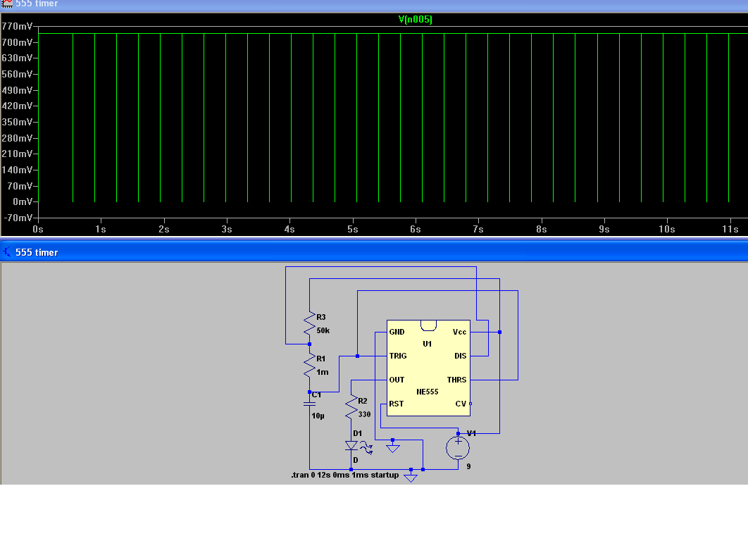

still no wave
here is schematic w/ corrections.
You still did not connect the Trigger pin and the Threshold pin to the timing capacitor C1.
Since your timing capacitors are backwards then the capacitor charges very slowly through both then discharges very quickly through the wrong one. Then the triangle wave will be a sawtooth wave.
well trying again??
supposed to be a square wave but it sure isn't what I was hopeing.

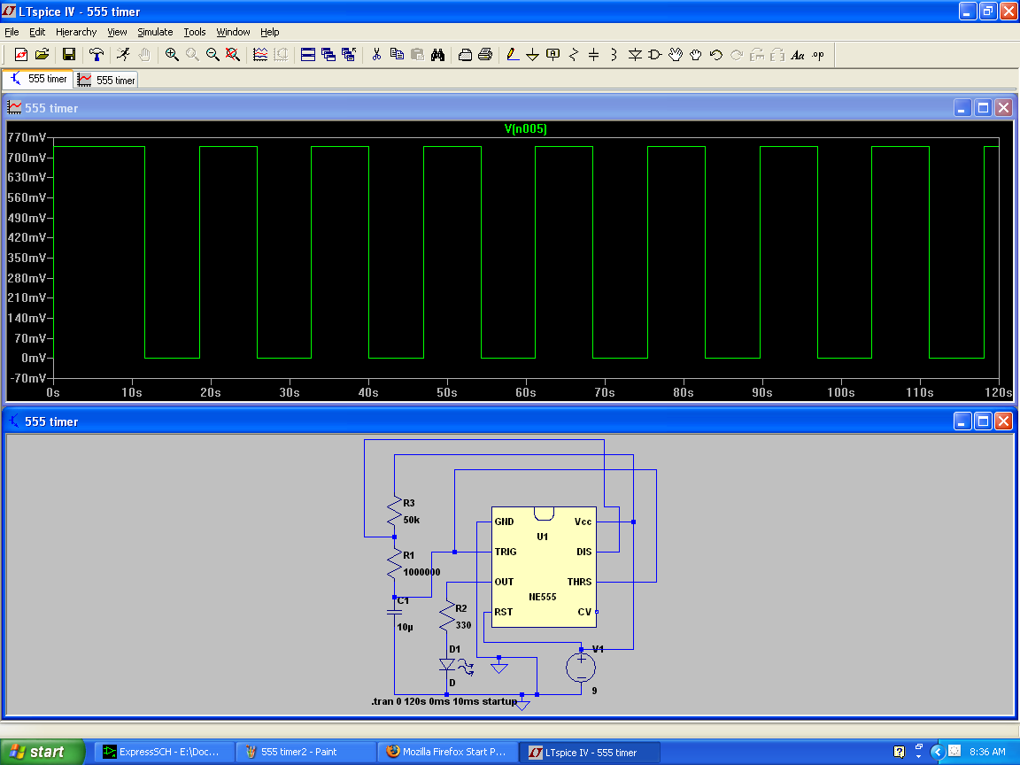

Your problem is you made R1 = 1m, which mean 1 milliohm. I think you want 1MEG for 1 Megohm. Right click the resistor and type 1MEG for the resistance value.
houston we have blastoff
changed to 1 meg and expanded to 120s

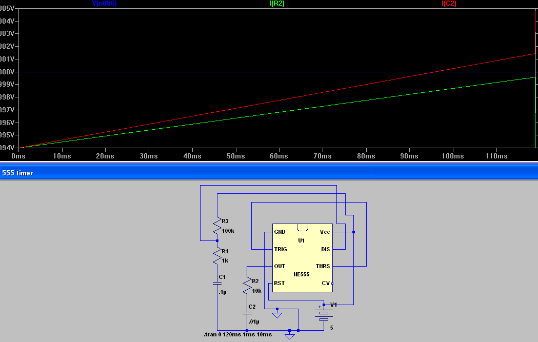

now to add transistor cap circuit
see post tiny schematic
