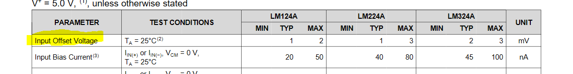

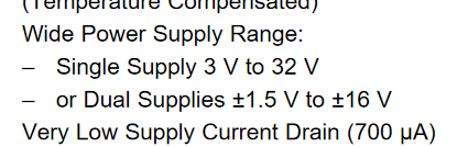

In linear operation you should probably care about operating votlage range and input offsets
In this case 3mV. That means with 0,1R sense resistor you can adjust to 3mV drop -> I = U/R = 3mV/0,1R -> 0,3mA

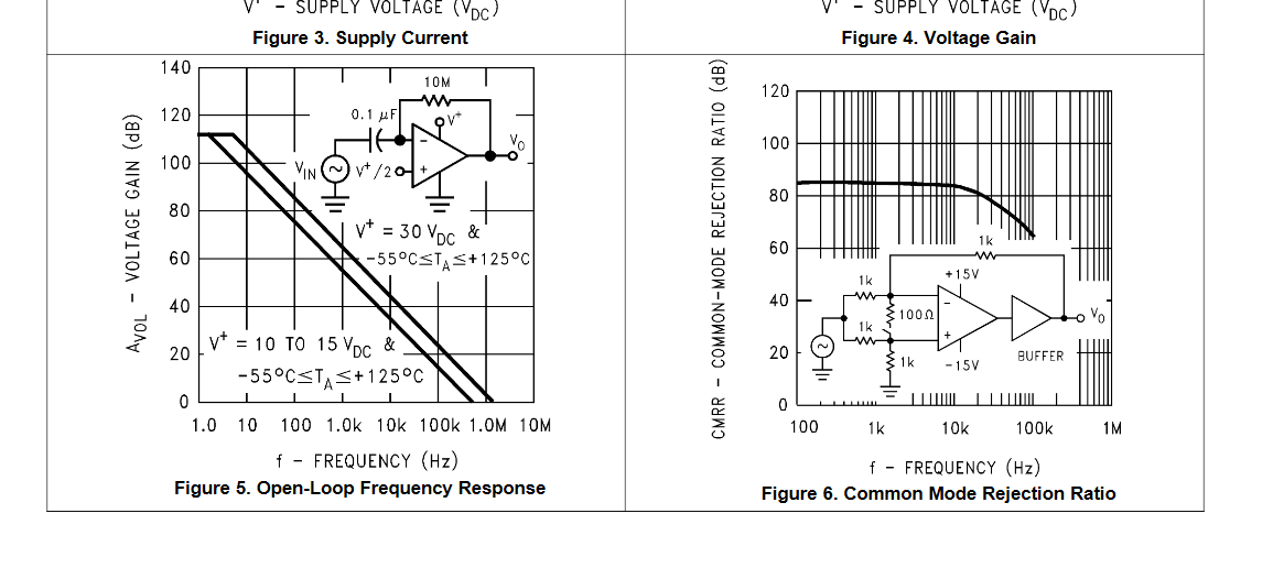

frequency response parameter is for fast reading. -> switching topology
