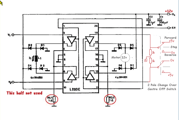

L293e
is a DC motor permanent magnet
Look at this image, it uses the LM293E shown in your first post.
