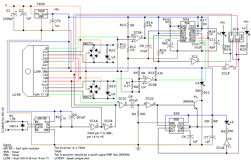

See attached for my most current schematic.
As for the new addition... do I need to throw the output of the filter into another section of the LM339 for comparison? (I do have 2 blocks free) or can I just use the output directly to the trigger in my 556?
My real question would be at what point does the 556 trigger? If it's a high/low then the delay of the filter would have to be a lot larger to keep the voltage way down a lot longer.
Otherwise I could see that routing the output into another comparitor at the full 5v would be a lot easier? No need for the pull up/down resistors and then the output tied directly into the trigger as per usual.

Hi again,
You can try a cap from pin 1 to ground first i guess,
or yes put another comparator section in series with that one
and work with that input. This will give a nice clean output.

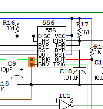

As the trig input from the 556 is direct from the LM339 output, I thought I'd throw it closer to the 556 as the ground was right next to it.

Hi Steve,
Ok, that looks like the cap is connected to the wrong TRIG input. It's
the other TRIG input we want to play with, on the right side of that
drawing (the green line).
Oh ok, i see you are working on the other side so that should be ok.
So the next thing to do then is wire in another section of the LM339.
We'll work with this next.
I have both triggers in use... they run via a section of the LM339 each and come off both of the 'sense' pins on the L298.
So I was just testing one side of the L298.
I'm more than happy to also test it on the other trip circuit.

Ok here is the route we will take...
Wire in another comparator section with its - input connected to two
resistors that provide a 2.5 to 3v reference voltage. The + input connects
to the cap of a low pass filter, and the resistor of the low pass filter
connects to the output of the first section. The delay can then be
programmed independent of the other parts of the circuit which means
we should be able to vary the resistor. 100k and 10uf will get us about
1 second delay. If that's not enough, we'll just have to go higher.
EDIT:
Wait, i think the 556 has comparators inside, so perhaps just a low pass filter
connected to the output of the first comparator. The 100k and 10uf
cap should still work for the first test.
Ok, the answer is this... no resistor and a 10uf (electrolytic, as that's what I had on hand) from the output of the LM339 to ground.
And it works perfectly... cuts of in a short, even on a very little short that I was having issues with previously.
The resistor seemed to not work at all... I can't even remember what the result was... it just allowed the short to occur, if I remember correctly.
The issue actually is that the Capacitor is always charged... and when the short comes, the output drops to 0... so the residual discharge drops the output... the resistor would slow the discharge, which is not the answer.
Now, on power on the short lights stay lit as the caps charge, but then all comes to life and works like a charm.
I don't know if the current solution is acceptable, but-it-works(tm) ;)
Thanks again!!
