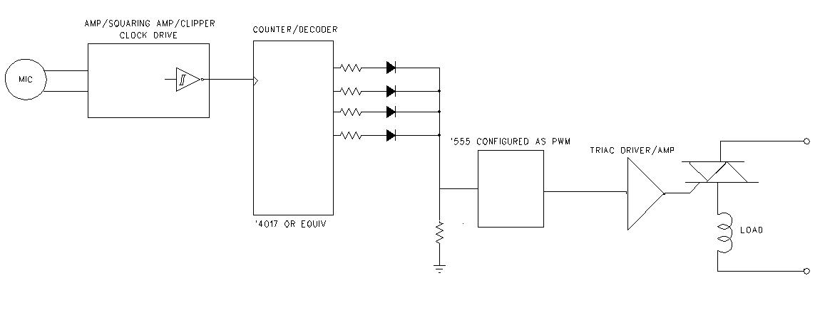

I have a light design that i need help with so here goes;
i has sound detector to turn the light on but i also want a dimmer switch on it, as well as this it has a motor to slowly turn the lights around.
What are the possable ways of doing this, thinking about cost first.

Here's one way it can be done. decoder sets variable on time. retrigger would be constant, so as to create a pwm signal. It may need a 556 (dual 555). The front end is what 'the Clapper' uses, hint: it processes sound (needs two sharp pulses w/i one second to issue a clock pulse) and it doesn't have a micro on it. Instead of the ctr/decoder, it has a bistable f/f to give on or off condition. I modified one to work on 9V instead of 120VAC (it uses a zener to regulate 12V for it's circuit board) and turn on a buzzer.

Good suggestion but I think this will require something more complicated than a 555 timer, although you could use the same bootstrapping mechanism with a PIC which will enable you to just connect the circuit in series with the load.
What voltage is the lamp?
If it's AC, you need a TRIAC and it will become much harder to have a simple series connection but it shouldn't be impossible.

That board looks ok and you can pull the clock pulse going into the micro to feed your dimmer circuit, but it seems like it's more than you need. The microphone front end isn't that bad. I once built a traffic light that switched on noise level from green to yellow to red for use in a school cafeteria. I didn't know how much gain I would need on my front end, so I built a prototype with mulitple gains set by dip switches and took my wife out to a restaurant to test it and set the ambient background gain. I don't have access to the schematic I used as it was for work and it went into my work notebook, but I do have the prototype I built and can retrace that for you.
Any electec micro amp schematic will work, you're just trying to put a driver on the output. The output of the amp will have a potentiometer to set the level at which the input sound causes the output driver to trigger. Since you are 'clocking' a logic chip, you don't want slow rise/fall times (analog circuit). That's why you see the 'scmitt trigger driver' ouput of the amp circuit. This will trigger at a certain 'threshold' level on the input and give a nice clean 'fast' edge on the output to the clock of the next device.
A project may seem 'daunting' at first, but by developing a block diagram (like the one I gave you) and then tackling one block at a time and getting each piece working before going on to the next you accomplish two things: you can see progress in steps as you go, and if you hook everything together and it doesn't work, you won't know what's wrong or where to start looking.
I would suggest you do the input block first. If you want to 'buy' it instead of build it, that's a project consideration (save time over money). If you have the time to build it, I would suggest building it. This is a simple project and it would enormously enrich your knowledge of how electronics work. Buying off the shelf and mixing and matching is what an EET does - EEs design their own!!!! (or know when it's best to buy off the shelf).
