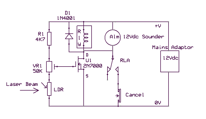

Like this?
What about a relay to keep siren on after beam is broken?
Also could I use just the photocell from the nightlight?
Something like circuit this would be OK.
EDIT: Measure the resistance of the light detector, when dark and light, let us know the value.

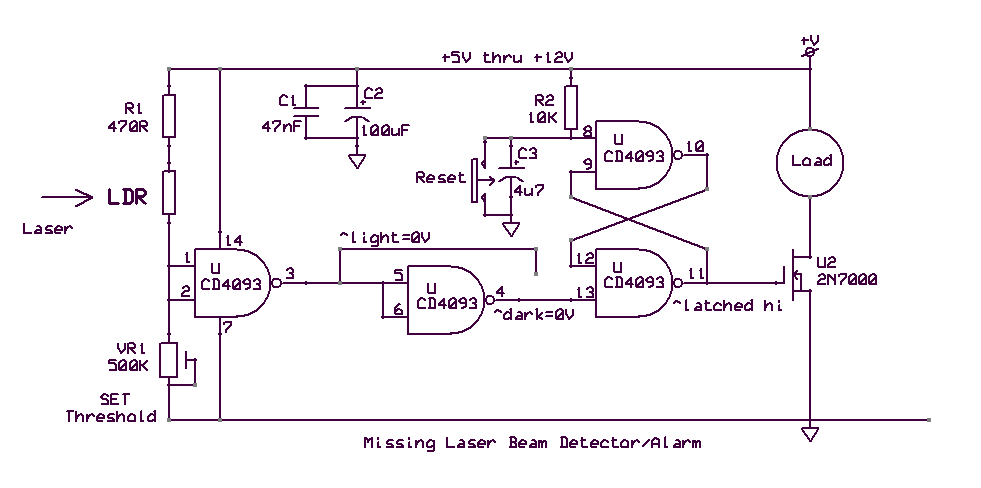

hi Dan,
Simpler version of the latching 'missing beam' detector.
Tested, works OK. Use a piezo acoustic sounder on the FET output.
Iam a novice I have no idea what parts are in your drawing. I would need a list or pictures of each part.
making the relay latch is really easy, just split the 'switched' output so it goes to the siren AND back into the coil, so once it is activated you need to cut the power to turn off the siren - although you could add a keyswitch or hidden switch or something to interupt the supply
Thats the circuit I posted on 17thOct.:)
So it is, i looked at most of the diagrams but i missed that one - a lot of diagrams in this thread.

hi,:)
No problem, for the simple application that first circuit would be OK.
I think that the second circuit is better in that it dosn't require a relay and the power requirement is lower
in the event Dan used say a 9Vbty.
