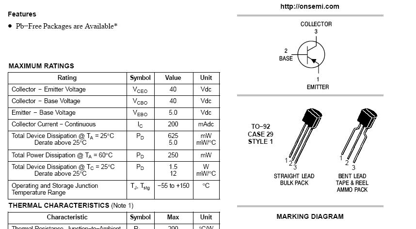

Can you tell which pins are which on the transistor(s)
This is necessary.

John -- Which pins are on the transistors? Well um, Pin 1-Emitter, Pin 2-Base, Pin 3-Collector. Is that what you mean?

are they like this ?
