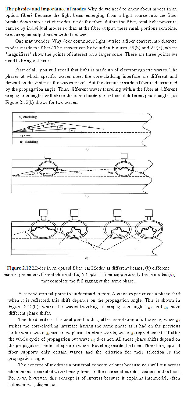

I think I was wrongly picturing the modes. Is there some simple way of explaining or thinking of modes? steveB : Sorry, I can't see any explanation of modes in your post and Google also didn't help me. EDIT: This is from the book I'm using.
What I conclude is that as diameter of the core increases, a fiber become multimode from single-mode or monomode.

I'm sure there are simple ways to help you visualize it. But, it would be easier at a blackboard. I 'll keep thinking of a way. For now, I'll try the idea of thinking of the modes on a drum. You have studied modes on a vibrating string, I think. You have a fundamental tone and higher harmonics that are allowed by the wave equation and boundary condition. A drum head is like a two dimensional vibration, if we minimize the damping and allow a tone to be produced.
Look at the animation is the following link. It shows a mode of a drum vibration. Fiber modes are a lot like this in that there is a two dimensional field distribution in the cross section of the fiber.
https://en.wikipedia.org/wiki/Vibrations_of_a_circular_membrane
To truly understand the modes, one must solve the electromagnetic wave equation that results from Maxwell's equations. The following reference shows this.
Yes, certainly. Also, the refractive index difference between the core and cladding, as well as the wavelength of light determine the modes. Even a single mode fiber will have many modes for visible light, and is only single mode for 1300 nm and 1550 nm operation.
I don't find this a good reason to to use multimode fibers when single-mode fibers can eliminate all those problems. I think it has got to do with high cost and sophistication required to handle single-mode fibers with a very tiny diameter.
That is exactly it. In particular, think about coupling light into such a small core. It is impossible to couple LEDs efficiently into a single mode fiber. Only a laser mode can be coupled well, and even then only with special lenses and very precise alignment and stabilization. It is interesting that when single mode fiber was initially considered, critics laughed at the idea saying the coupling light from sources and coupling from fiber to fiber would be impossible. This is a good lesson because such critics always underestimate human ingenuity to solve the next problem. What people do now far surpasses what anyone thought would be possible. Lasers can be couples to single mode fiber with only a few percent loss. Fibers can be fusion spiced together will essentially no loss at all (for all practical purposes). Fiber to fiber mechanical couplers/connectors now have losses less than 0.1 dB and are super stable.
Hence, single mode fiber is very practical and effective, however cost will naturally be higher to deal with the tolerance and alignment issues. This is why multimode fibers and plastic fibers still find use, even though they are not as advanced as the single mode technology. Engineering and manufacturing always consider the cost/complexity needed relative to the application.
