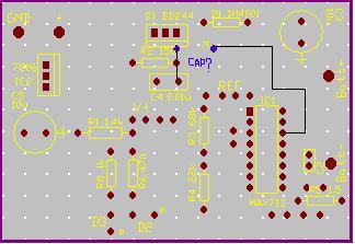

i have it all done except for im waiting for the volt reg and power transistor, and the placement of one cap. Thing with the cap is that i dont know where it would go on the pbc placement, it seems to not appear there, could anyone tell me where it would go, its 1mf cap, supposedly its number C1 which icant find?, here...
would it go right ontop of the R2 resistor just the the right of it, (near the top before the transistor)? Or where else?

Looks to me as if its been missed......according to the cct, it should be connected between pins 12 and 15 of the MAX.....just stick it on the underside...not elegant I know....
thx chippie, would anyone know what is connected aboce the R2 and below the Q1, those two dots, because i have to connect pin 11 to the right dot. also, if i used a electro 1uf cap on which pin should the negative go? or should i not use an electro?
pin 15 is the second from the top on the right? (lol sad)

Connect the 1mike cap with its +ve to pin 15 on the MAX which is on the top right........... 8)
Dunno if you sussed it yet, but the component layout and the underside layout are the same i.e as seen from the component side of the board......may help in laying out :lol:
actually i found a mistake in my pbc, i forgot to connect pin 14 (DRV) which appears to be connected to the transistor. To waht pin of the transistor or where else would i connect it to?
on the attached pic of the component part, there are two "dots" which one is connected to the transistor and the other is connected this pin 14. should there be something put into those two pins (ie a cap, resistor, etc) that would somehow connect those two dots, if not pin 14 would just be left hanging, so to speak. kinda confusing me.

Pin 14 goes the base of Q1.......the common junction of Q1,R2 and C4
