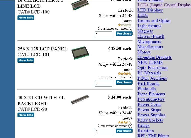

Hi Dan,
I thought the little 1.5" display on this page was interesting but never quite found the $55 to order one (grin);
I scrolled through both pages of their LCD category and I also typed "LCD101" into their search field and neither produced the product...
Check this attachment.
Found it... Sorry... Don't know how I missed it the first time... Looks like a rather nice display for the money, BUT, it's not backlit and it's not color...
Regards, Mike
That looks like a handy little display - the type of hardware that begs to be utilized in a slick project. However it won't suite my current project. It is not large enough, and doesn't appear to be transflective, so it wouldn't be visible under direct sunlight.
heida11, that's also a nice looking display, especially for the cost. However I require a backlight, and a slightly smaller display.
Thanks for the suggestions guys!
