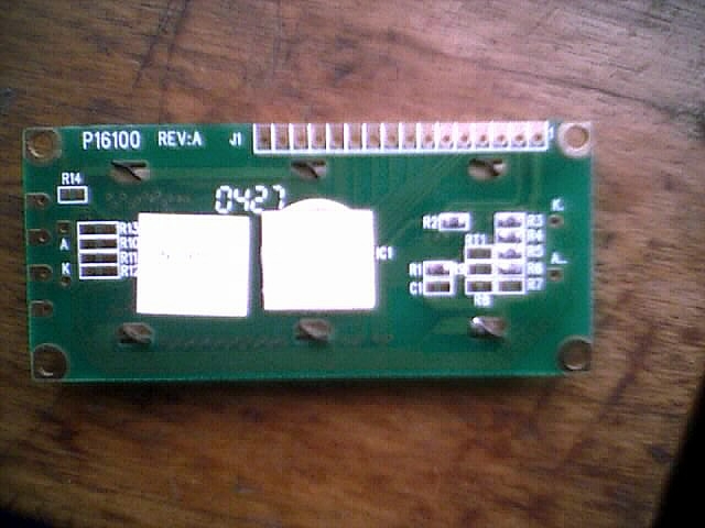

I hav this LCD. I don't know the manufacturer and pinout, if its is HD44780-based. How do I know? I saw this name on the back, P16100. Please help!

Please post a picture of pcb.
The HD44780 is not the problem its the layout of the pins on the pcb.
Are there 14 pins or 16 pins, one end should have the number '1' near a wiring connection.

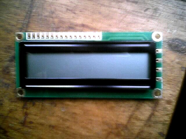

Thanks for your reply, Eric. The LCD has 16 pins and yes one end has the number "1". Below are the pics.

Thanks, Eric. What is d function of pins 15 & 16? Is it 4 backlight?
I am not sure what pins 15/15 do on that LCD, as I dont know the type of pcb/manufacturer.
The set of solder pads at the other short edge of the pcb are most likely to be for a LED backlight.
I'll look around for info on pins 15/16.
EDIT:
Found a printed document, to faint to copy.!
Says pin 15 is LED+ and pin 16 is LED-
BUT, if you look at the printing on the backside of you pcb, its marked +K, +A at one end and -K and -A.???
I think your LCD is manufactured by GOLONE China.maybe a SGL-VCM1602A
... and here follows the translation: "K" means "Kathode" --> English "cathode" and "A" means "Anode" --> English "anode".
If it's a German design manufactured in China the pin describtions were obviously misprinted. They should be -K and +A.
The backlights of LC-displays vary in current flow (commonly 50mA). Use 100Ohms in series and connect to VCC and GND. If connected reversely the display stays dark, the other way it will light.

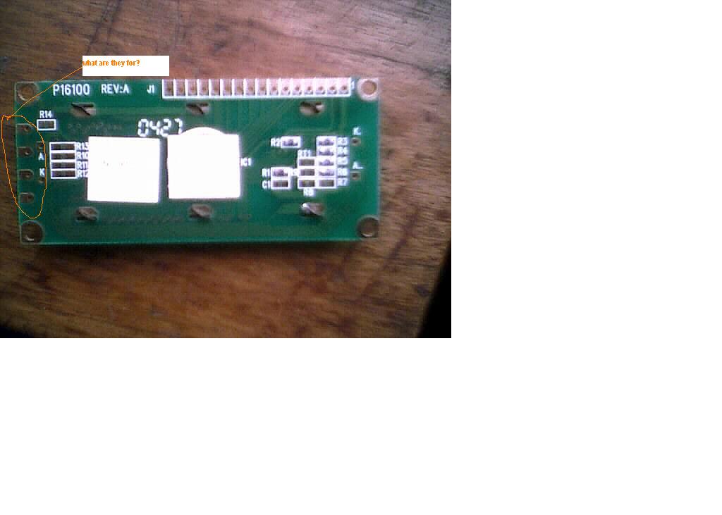

i got the same lcd recently and am trying to use it to display liquid level but i want full description on the function of the pins and the order of pin arrangements(i.e. from what point should i start counting the pins). i also want to know the functions of the four pins by the left u can see them in the attachment
