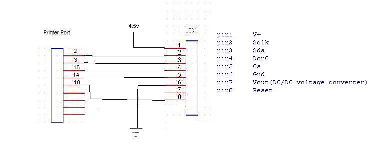

is my connection correct? also wat should i connect to the Vout?
pin 18 of printer should be pin 17

this are all the infomation that i have.
i got a nokia 3310 which i wish to program through parallel port using c language..
can anyone help me with it?
i just need to know wat are the connection to be made and how to initialize the lcd. Also i need the voltage lvl that is needed for the logic of the lcd..
for my lcd, there are the following pins.
pin1 V+
pin2 Sclk
pin3 Sda
pin4 DorC
pin5 Cs
pin6 Gnd

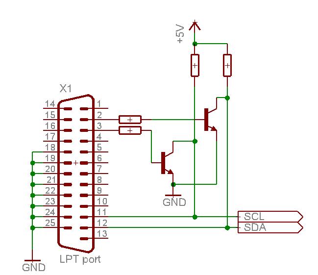

You can use the LPT port for I²C but you have to add a little extra hardware (some resistors and transistors)...
The clock and data lines have to be pulled up to 5V each with a resistor
and each connected to an input pin of the LPT port. To allow software to read the current status of clock and data...
Then 2 output pins of the LPT port must each be connected to a transistor switch to be able to pull clock or data low...
This because I²C is a open collector bus...
If you don't understand i'll add a scematic later... but i dont have the time now
You will also need to get a grip on the I²C protocol if you want to write software for it... do a google search on "I2C Protocol"

here's my setup... this works and is in use. I use it for TV/Video repairs. Allows me to monitor the bus with my pc. I wrote the software for it in watcom c++ (for dos). But you should be able to do it in windows with visual basic or something
I don't know anything about the lcd itself. So dont ask me where to connect Vout. :P

Yes, BC547 will work fine. I use 10K as a base-resistor
For the pull-ups it depends. Philips uses something in the range of 300 ohm. But i got devices running here with pull-ups as high as 4.7K and still work (consuming less power)
erm... why is the voltage at 5v?
from this datasheet page 5, it says that the voltage level is 2.8-3.3V and also all voltage input level is 0 and 3.3.
so should i change to 2.8-3.3V? im afraid that i might burnt the thing, so i haven test yet...

Apply a 3.3V power supply to the pull-ups. It is the voltage you apply to the pullups that will be fed to the lcd's bus
what does the base resistor and pull up resistor do? how can i calculate the values? i dun want to burn my lcd so im a bit careful in trying to find out the correct values..
The base resistor is a current limiter for Ib. Without it the transistor will blow. I always use a 10K when using a transistor as a switch. Never had problems with it.
The pullups keep the bus high when inactive. And prevent a short-circuit when someone pulls the bus low. The lower this value, the lower the propagation delay on the bus (good) But the more current you waste when a bus line is low. 470 ohm should work fine.. You can go higher but it's better to experiment with this once u got it working.
as for my parallel port, i realise it gives out around 4V which is not to my needs so can i just add some resistors to it to reduce to 2.8-3.3?
The 5V of the parallel port is only used to switch the transistor on and off. It is the voltage applied to the pullups that is the lcd's bus voltage
