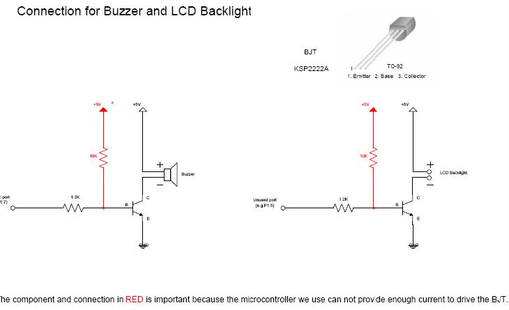

i manage to spot something amiss.
The Transistor that connects the buzzer seem really hot. After taking it out. My LCD contrast went back to normal.
Anyone know what happen to it, i'm sure i didn't mix up the polarity.
thanks
Usually the backlight has a low value series resistor!
EDIT:
What are you using for a buzzer.?
