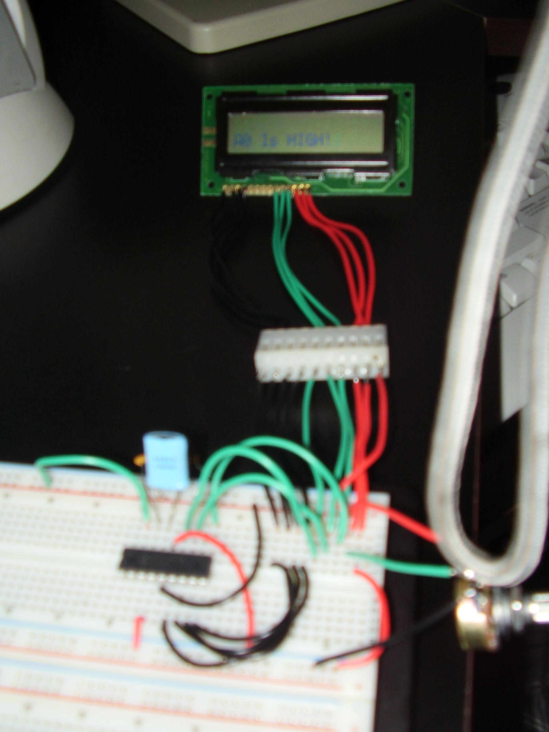

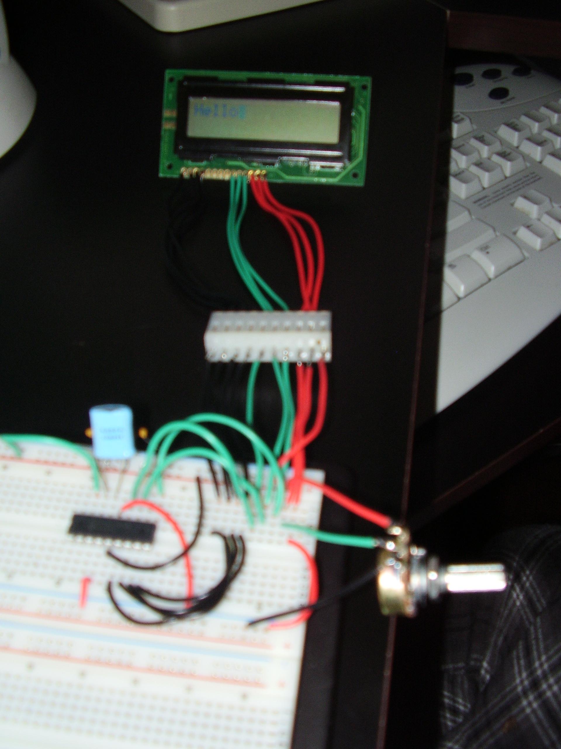

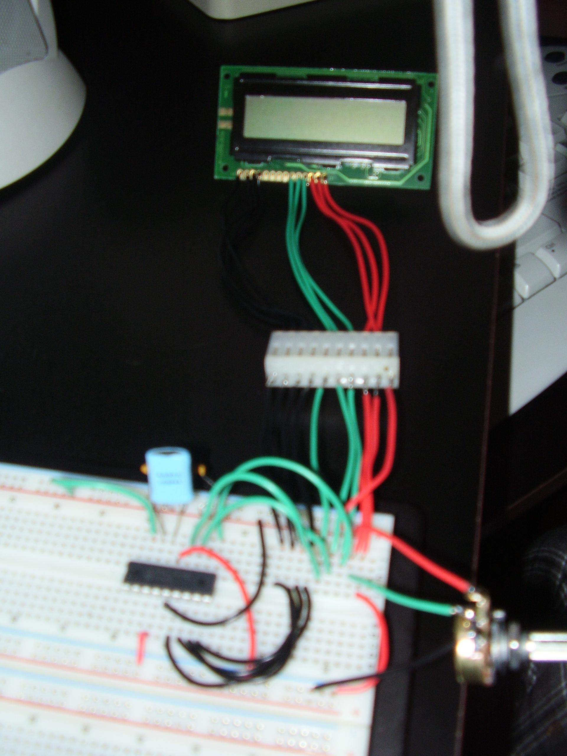

Nigel Goodwin said:
Is it just me? - you post tutorials on the net, with proven working code and hardware, in use by large numbers of people all over the world. Then someone connects it up differently, blindly bodges about with the code, and wonders why it doesn't work.
This is the LCD equates from the tutorial code, to move it to PortB all you need to do is alter PORTA to PORTB, and TRISA to TRISB - it's that simple. Connect it as shown in the tutorials, alter those two letters - and it works on PortB. Why connect it differently?, if you want it different then write your own code!.
LCD_PORT	Equ	PORTA
LCD_TRIS	Equ	TRISA
LCD_RS		Equ	0x04			;LCD handshake lines
LCD_RW		Equ	0x06
LCD_E		Equ	0x07
Nigel,
Im sorry if this has upset you.. changing your code and all.. I should have asked you first.
Thanks for bringing up the include. file .. I had forgot about them from the MPLAB tutorial.
Its all good and dandy on PortB now ..if it means anything
Good Deal
PW:rolleyes:
No problem, and I'm not upset, the code is there for anyone to use and change as they require - just that you changed known working code, and then wonder why it doesn't work?.
:D All systems GO :D
