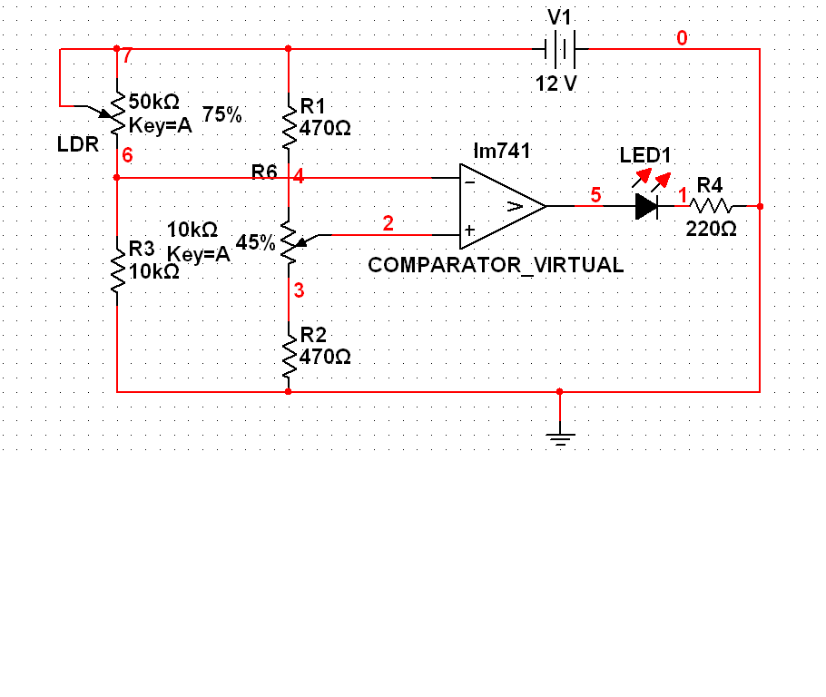

Hi can any 1 tell me or show me how to make an LDR circuit on a copper strip breadboard so that the LED lights when the lDR is in darkness thanks. The power supply is from a 9v battery.
here is a schematic
assuming you can read a schematic?
if not then maybe I can draw with boxes etc.
the schematic has a potentiometer in place of the LDR. not a big deal.

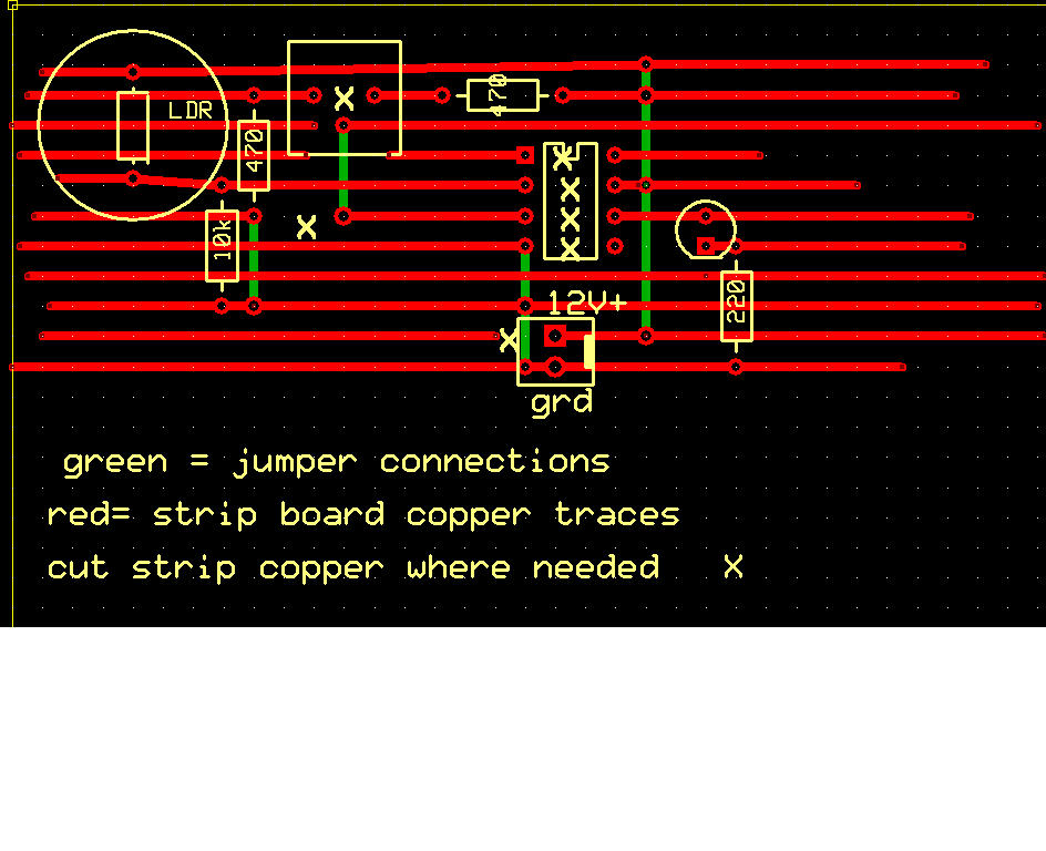

I can read that drawing but im still not sure how they would all be placed on the copper matrix board. I have drawn a schematic and in mine I have got 3 resistors the LDR an LED and an npn transistor just not sure where to place them all on the matrix board**broken link removed** that image is the type of board i am talking about exept black strips are copper.
hey,u have to make series and parallel connections with wires on the copper breadboard....check the connections on the schematic and make them ditto on the board..simple.
this should help
just cut traces where they are not needed
