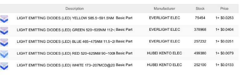

Here are the "basic" 0603 LEDs available, so pretty much the standard colors. There are many pages of "extended" 0603 LEDs available – using an extended part is find if you can't find what you want in the basic list, but it adds a $3 service charge. There may be a limit on how many different extended parts you may use. I think it was limited to 10, but I'm not sure that still applies.

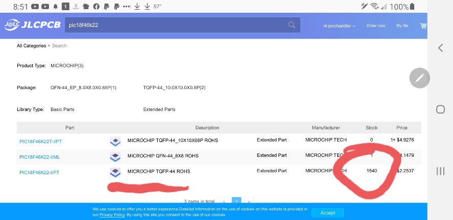

When designing for assembly, you will save yourself a lot of grief by selecting available parts as you go, rather than going back later and updating details for every component on the board. This is especially true for the micro if it's in a different package with a different pinout. <Voice of experience.

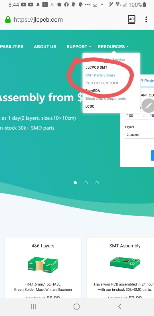

The easiest way to select parts that are in the assembly program is to go to JLC's webpage and find the SMT LIBRARY under the RESOURCES tab.
(Click on the screen shots to enlarge)

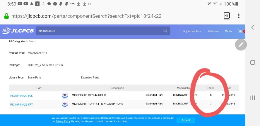

Let's look for the PIC18F44K22. Enter it in the box at the top of the library page, and you'll get this. Oops. Only a few available in any of the package options. Bad choice.
The 18FF46K22 is the same part with more memory. Maybe it's a better choice?
Ahh. Lots of those available, in a TQFP package. Any package is OK, since JLC is assembling it. Looks like a winner.

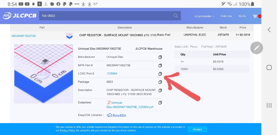

Clicking on the part number brings up the page for this part. Lots of information there, including a link to the data sheet, which is very handy (although sometimes you get the Chinese language version). What we are most interested in is the LCSC part number. Click on the box at the right end of the row to copy this number to the clipboard. Then go into EasyEDA, paste this number (CNTL-V) in the search library function, and place the part on your schematic.

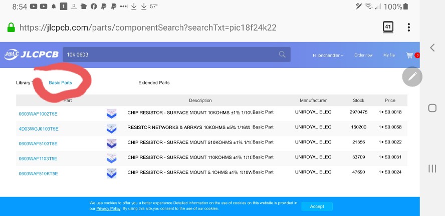

How about looking for other components, say a 10k 0603 resistor. Enter it in the search box on the JLC page, and you'll end up with several pages of parts.
This list includes basic and extended parts, of things including "10k" in the name, like 510k resistors. Let's narrow it down by clicking the BASIC option at the top left.
Read very carefully to select what part you want to use and click the part number as above to go to the page for that part. READ the description carefully to be sure it's the value you want. Use extreme caution. The way the list resistors is "10Ohm" – that's not a 100 ohm resistor. It's a 10 ohm resistor jammed against the capital O of ohm.
