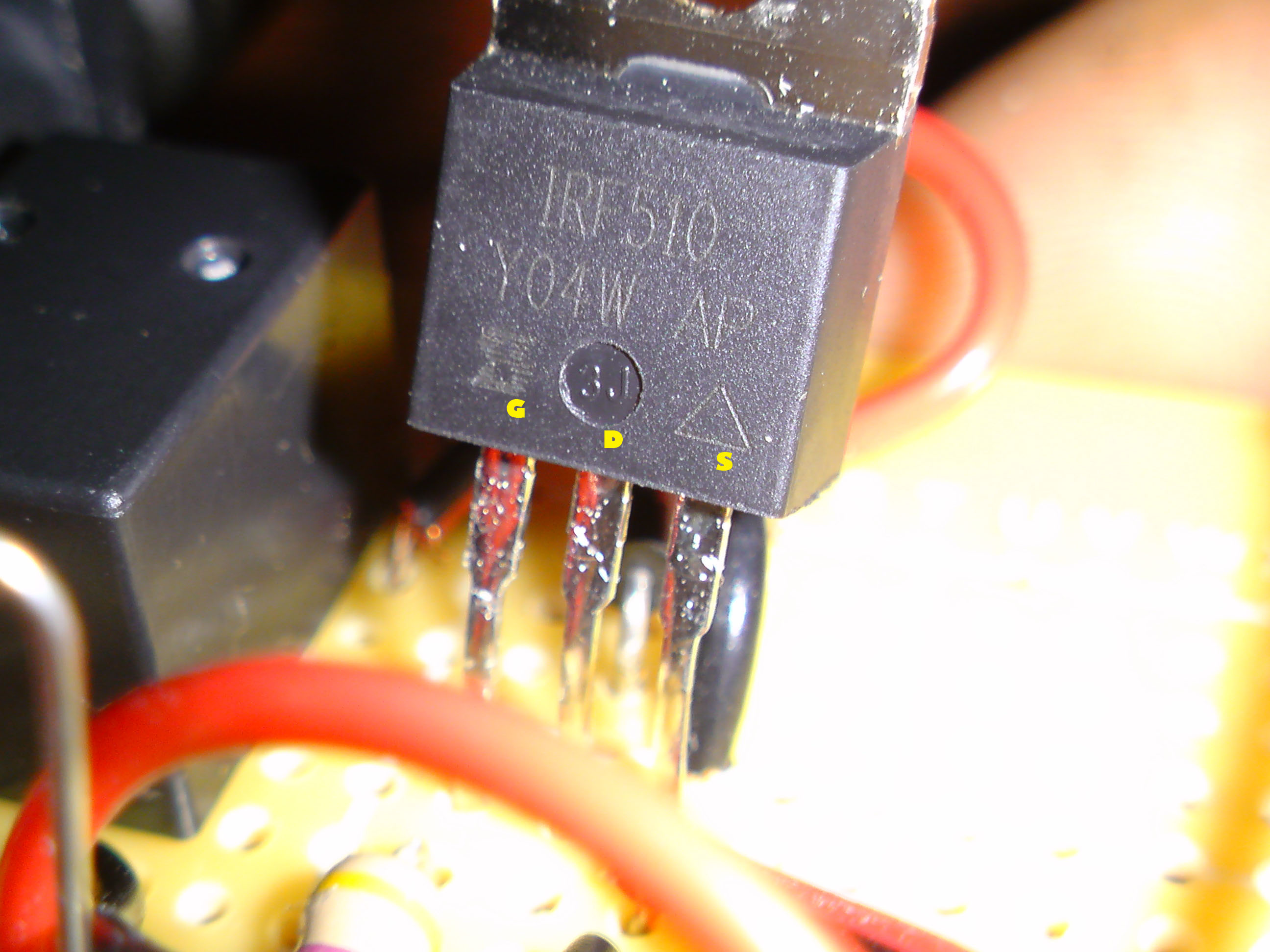

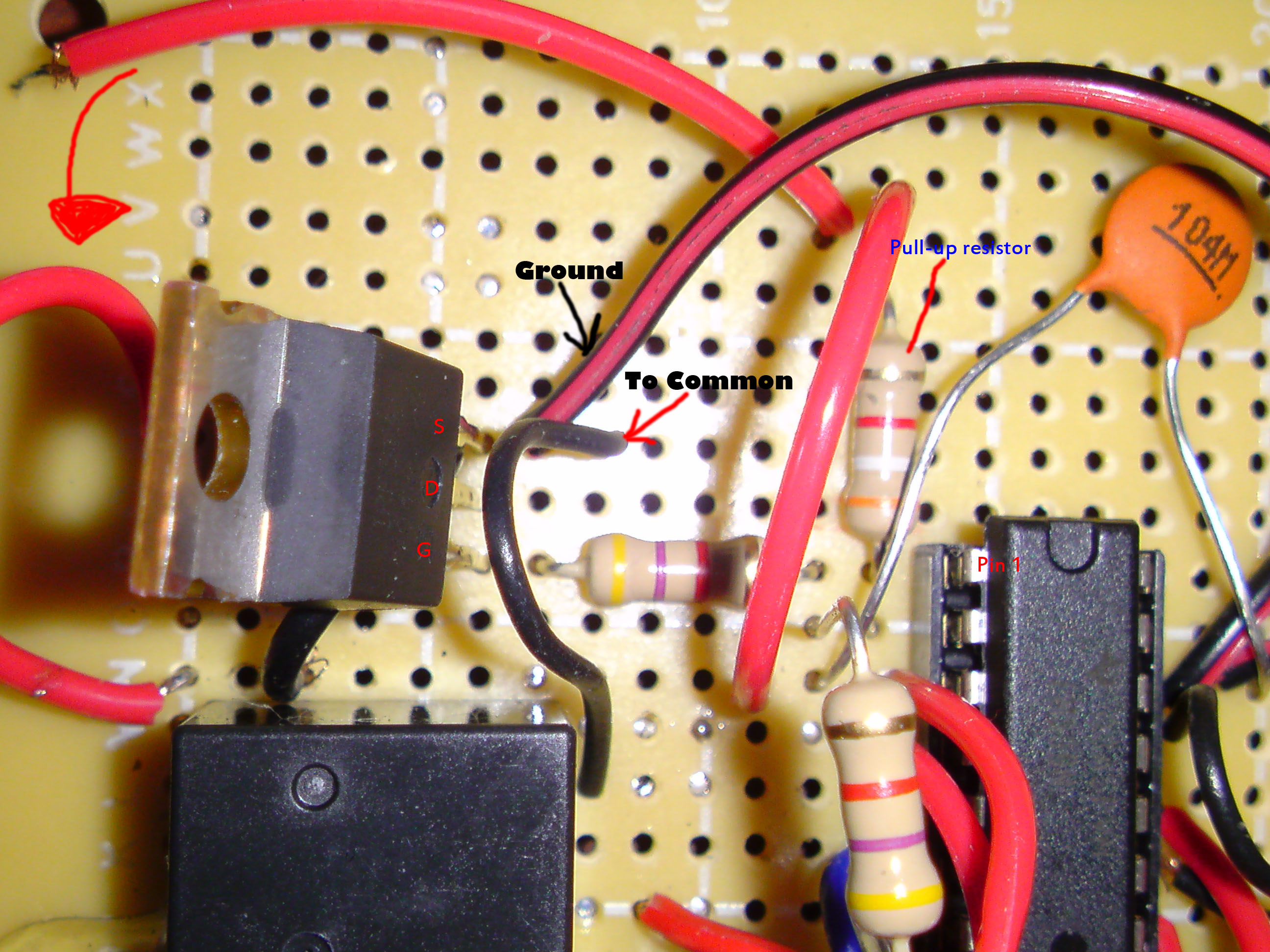

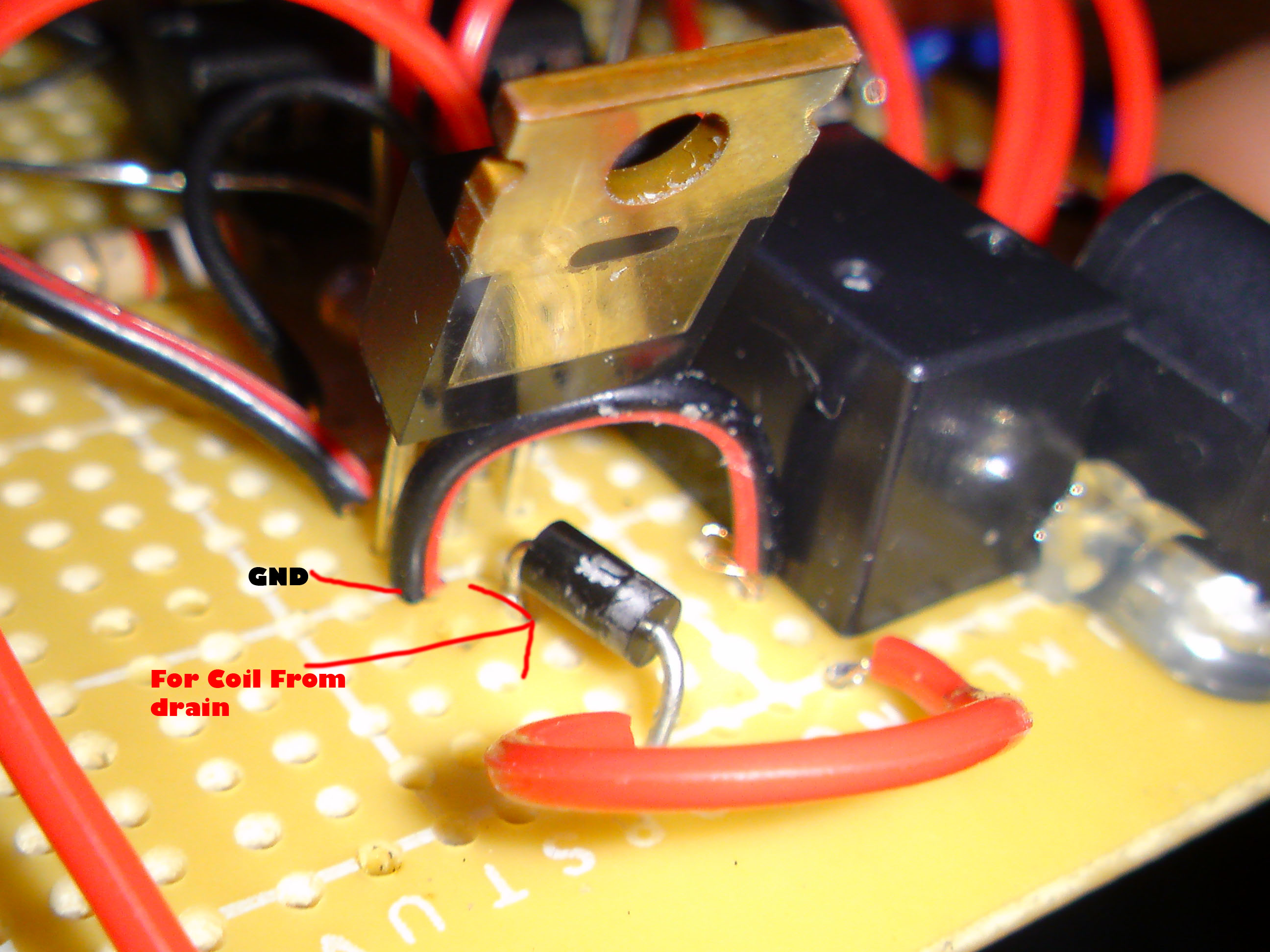

to be 100% sure the gate is from the 339 output with the resistor, the drain goes to one side of the coil which also has a relay and the source goes to the common?
Where I get confused at is after the pullup resistor it should go to the coil, no?
here are some pictures I took

In part it should look like the attached and yes, your IRF510 MOSFET is labeled correctly. The pull up is shown.
