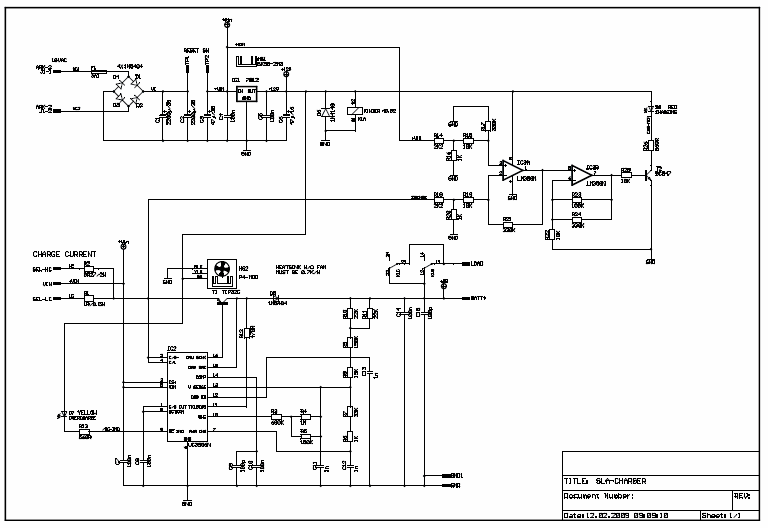

Hi taz128,
you might get a good qualitiy maintenance charger using an UC3906 (Texas Instruments)
This circuit prevents current flow to any load while the battery is being charged in order not to get erroneous readings for the chip.
The chip was designed to charge SLA-batteries (Sealed Lead-Acid), but it will certainly also work for wet batteries.
Here is the schematic. If you also want a PCB layout pleas PM me your email address for the Eagle files.
Boncuk
