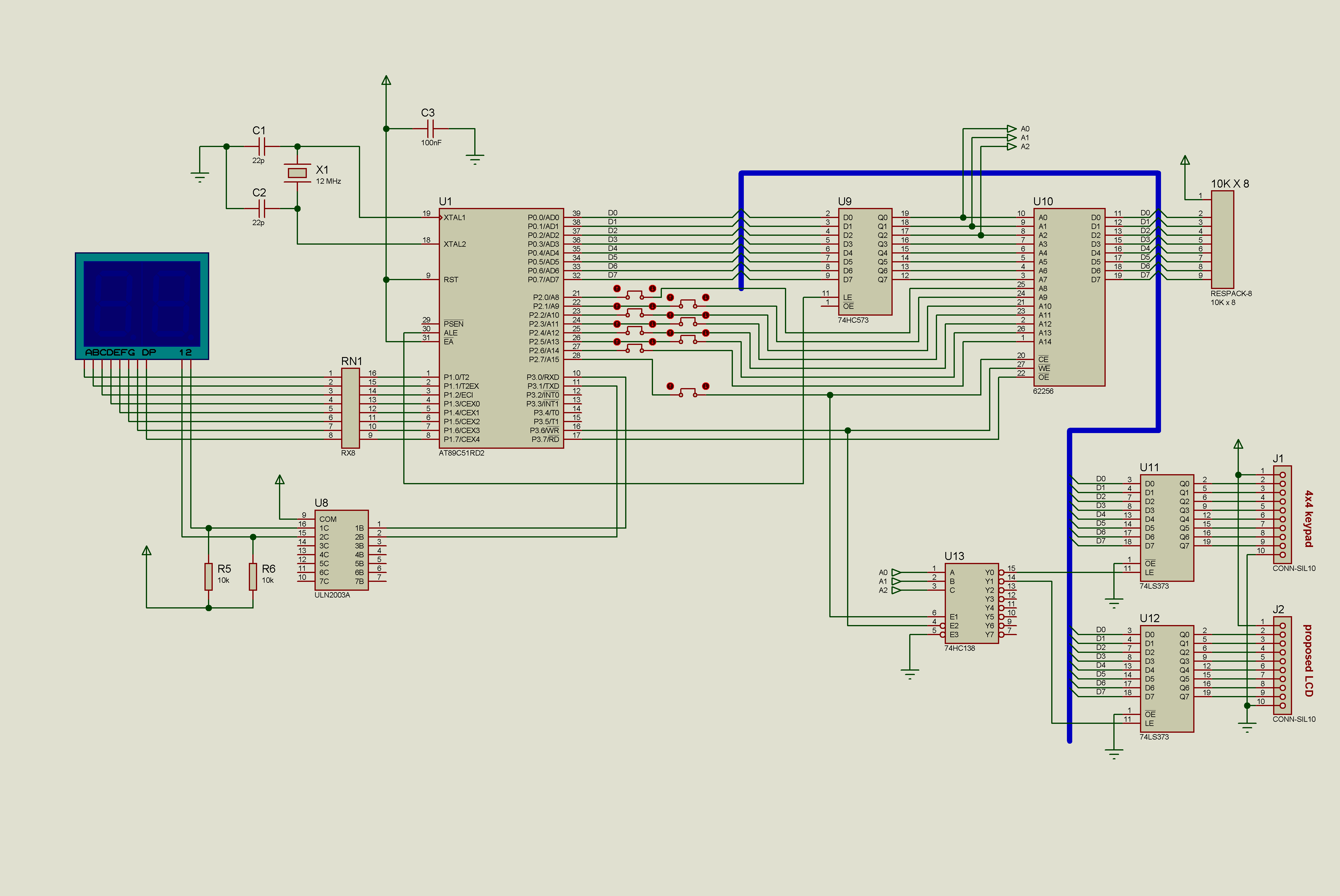

Attached is my 8051 development board with 32Kx8 SRAM 61256.
Where do the 3 wires on the SRAM ie. /OE, /WR & /CE go to?
Can I leave the /EA & /PSEN not connected? I know I need to put 10K pullup resistors on port 0. The schematic is done in a rush.

If you are using the external data buss to parse/fetch data from external RAM you won't need pull up resistors on P0. They have strong internal pull ups when used as the external front side bus.
On the RAM -
/OE would go to the P3.7/RD pin on the 8051. This is the read strobe input.
/WE would go to the P3.6/WR pin on the 8051. This is the write strobe input.
/CE is typically used as a paging pin to lock the memory chip into a block of memory. This pin should go to P2.7/A15. This locks the memory chip into the 0x0000-0x7FFF region of memory space. Reads/writes to the 0x0000-0x7FFF will read/write to the memory chip while reads/writes to the 0x8000-0xFFFF region will do nothing unless some other piece of hardware is using that address space.
/EA = External Access. This pin must be tied to +Vcc if using the 8051's internal program memory
/PSEN = Program Store Enable. This is the read strobe when using external program ROM. It does not get used when using internal program memory and can be left disconnected.
That's very informative. And here is the updated schematic.
I added 2x 8 bit latches 74LS373 (I got plenty) as output ports for LCD and keypad. Can I use 74LS374 or 74LS323 8 bit F/F instead ?
Is there anything wrong with my reset circuit ? Do I need a reset button? As you see that I put in 16 jumpers on the Data and Address just in case I need to make use of port 0 and port 2.

The 74LS series is way outdated. I use the 74HC/HCT series, which are TTL level CMOS rather than bipolar, hence they consume less current than standard TTL devices.
I use the 74HC573, which is functionally identical to the 373, just with a more convenient pin out.
The 74LS323 is a shift register, not a latch.
The 74LS374 is basically the same as a 373, but the CP pin takes the place of the LE pin and it is edge triggered vice being level triggered like the 373. Seems like it would work, though I cannot say 100% since I've never tested it before.
The reset circuit on the 8051 is active high (backwards from PIC and AVR, which are active low reset). You have it tied high with a pull down capacitor. You should have a pull down resistor and an optional pull up capacitor. A 10uF cap from RST to +Vcc with a 10K resistor from RST to ground will provide a 100mS power on reset. Reset button is optional as well, but it must go between RST and +Vcc.
Thanks, I'll try with a 374 and see if it works. Will report back if it doesnt.
That's why I felt a little suspicious, but the sample files in my proteus was wired up like that so I just follow their mistakes and it seems to work just fine.

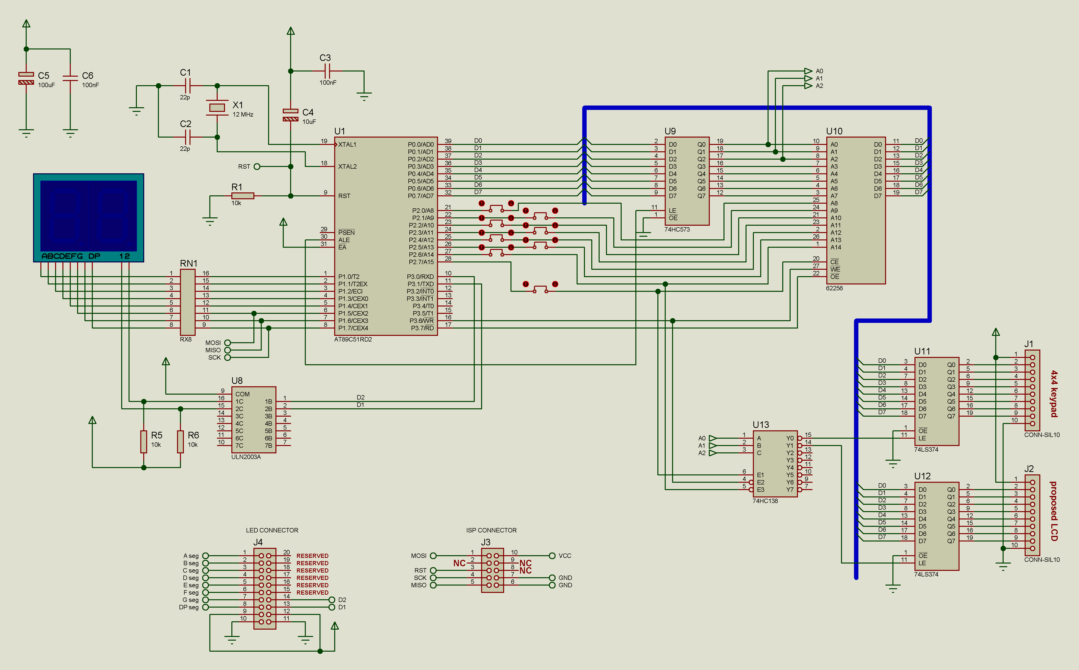

I attached my latest circuit for my 8051 dev board.
Here I have a couple of questions regarding the circuit.
1. What role does "RST" play in the ISP programming? Does it also supply +12V to 8952 during programming? If that's true, will the 10uF, 10K Power On Reset disturbs the programming of the chip?
2. If /EA is tied high, Could my external SRAM be able to run programs?
I also connected E3 of 74HC138 to A14 so only 0x8000-0xBFFF are used for I/O.
RST doesn't supply anything. It is an input pin. This pin should be externally pulled high (5V) when in programming mode. You would end up having to disconnect RST from the external cap/resistor and tie the pin to 5V with just an external pull up in the range of 4.7K - 10K when programming the chip.
Out of curiosity, what programming hardware are you using? I use the AT89ISP cable, which should be able to control the high/low setting of RST when in programming mode regardless of the external hardware.
2. If /EA is tied high, Could my external SRAM be used for running programs?
When /EA is tied high, external code execution only occurs when the internal program attempts to address a code memory address that is past the internal code space via acall, lcall, ajmp or ljmp. In the case of the 89S52, this would mean that the code would have to jump to a code memory address range of 0x2000-0xFFFF in order for external code execution to take place. Code execution on addresses 0x0000 - 0x1FFF would take place from internal memory.
However, when /EA is tied low, all code is executed from external memory.

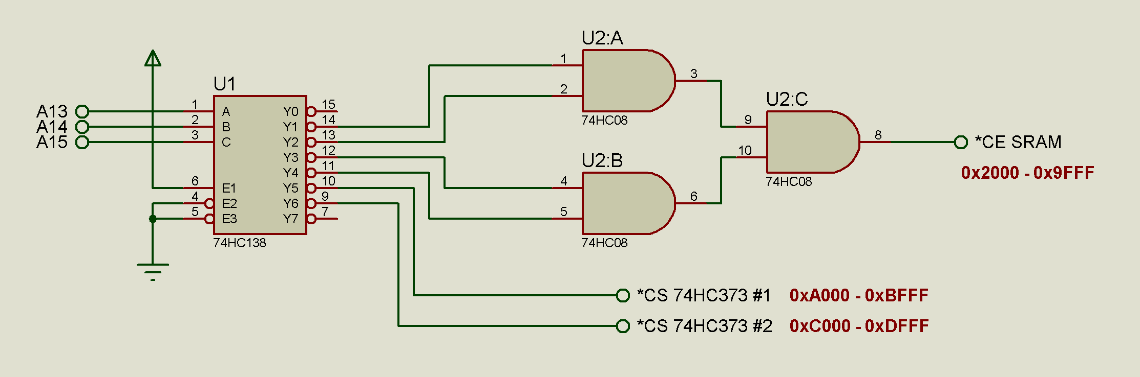

Allen
A 74HC138 is a 3-8 address decoder. How it is meant to be used is to divide the external 64K of external RAM space into 8 blocks of 8K by connecting the A0-A2 pins of the 74HC138 to address pins A13-A15. /E1 and /E2 are usually tied low directly while E3 is tied high directly. Then, the Y0-Y7 pins are used to drive the /CE pins of each memory chip (or other external hardware) low when each block of 8K xRAM memory space is addressed -

This would allow there to be 8 RAM chips of 8KB each on the external buss. Or you can have a single 8K memory chip and other multiplexed hardware on the bus by using buffer chips with either an output enable or a chip enable pin, then use the Y0 - Y7 pins to assign the other external hardware to an 8K block of external RAM.
Make sense?

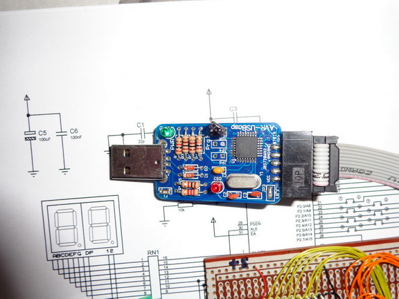

the programmer that I have is attached for your ref. It was designed for AVR and some of the internet software that I found might support the programming of 89S52.
Failing to program my 89S52 than I would have to construct the programmer from here:
OR
Make sense?
Yes, that makes perfect sense. I will consider that decoding scheme but then I would need a 4-input AND gate to 'and' the outputs of Y1 - Y4 for my 32K SRAM. The schematic would look something like this...... Looks like I need another sub-board for the decoders.:rolleyes:

The AT89ISP is available from my local Farnell. I am not sure if it is worth to invest $40 for it as I know I can build one that works almost the same.
Here is an update of my 8051 dev board and the AVR programmer that I have.
Allen

Actually...you could just not use outputs Y1-Y4 and tie the CE pin on the SRAM to address pin A15 on the 89S52. This will make it so that only addresses 0x0000-0x7FFF access the RAM (A15 low). Anything above that will drive /CE high via address pin A15, thereby free'ing up addresses 0x8000-0xFFFF to be split into 8K blocks via outputs Y5-Y8 on the 74HC138 (A15 high). That will save you some hardware gating.

Since I don't have a USBASP programmer, I temporarily used my old 20-year old parallel printer cable and turned it into an ISP with a 74hc244 soldered. I used the programmer software from http://dybkowski.net/content/en/node/15.
Also, I used the SDCC compiler since I don't feel like downloading Keil (trial version) as my connection slows down nowadays.
