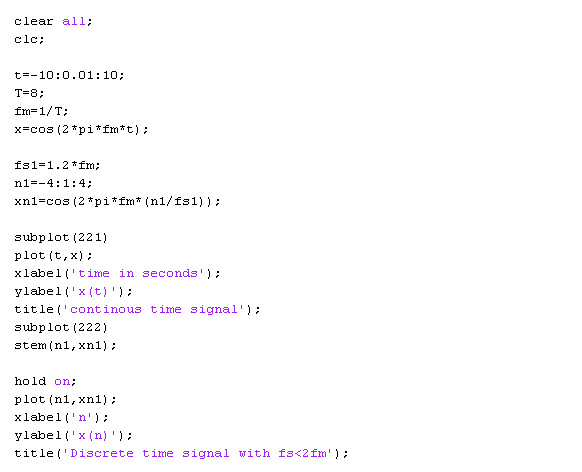

Hi
I have been trying to write a code for sampling and quantization for last two days. I have figured out sampling part but need your help with quantization part. I have found this code but the problem is that I can't understand what is being done in quantization part, and I do believe the quantization code could be simpler because I need a straightforward code without embellishments. Moreover, I'm interested in 4-bit quantization and the desired number of samples could be 13. I want to do something similar to this. Please help me. Thanks.

I didn't try to understand the code (I hate figuring out other peoples code, especially when there are no comments )
But it seems to me that the "floor" function is suitable for quantization, and the fact that you are quantizing to integer values makes it easier. I'll give you the equation assuming inputs and outputs are decimal numbers, and if you need binary representations, I'll leave it to you to do the conversions.
For any function x(t), find the x-values at the sampled time values, and put them in the vector called "x". Then "x_quant": is the quantized value of the sample.
x_quant=max(0, min(15,floor(x)))
The min and max functions simply ensure that you are in the range of 0 to 15 for 4 bit numbers, and the floor function rounds the value down.
steveB's code is good for quantisation. You do need to bear in mind that x will have to be scaled before using floor to quantise, and then x_quant has has to be scaled by the reciprocal if you want it to have the same scale as the input signal. If you just want the values {0, 1, ..., 15}, then the second scaling is not required.

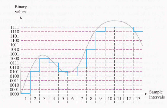

I'm sorry but I'm still not able to do it. I have tried and was able to move forward a bit.
x=[0:1/15:1]';
y=cos(2*pi*1*x)
stem(x,y)
round(y)   % don't you think using round() is better than using floor()?
% for conversion from decimal to binary we can use the function dec2bin(d,n)
I don't understand how, x_quant=max(0, min(15,floor(x))), works. For cosine function minimum value is going to be -1 and maximum +1 therefore to get 15 quantization levels (or, 4-bit quantization), we need to set quantization scale at {1-(-1)}/15=2/15. Please help me. Thank you.

OK, dougy83 pointed out that you need to scale to get into the range, but in your case you seem to need to shift and scale to get the function in the 0 to 15 range. I wasn't really worried about this because your plot seemed to show a function already conditioned, but obviously I assumed the wrong thing.
So just shift your function so that it starts at zero and scale it so that in ends at 15.
Also, you can use the round function if you prefer. However, when i looked at your plot, it appeared that the values were being rounded down, which is what the floor function does.
EDIT: By the way, if you do condition your input signal by shifting and scaling, then you dont' need the min and max functions because there is no way for the signal to be out of bounds. Still, you may want to keep those in place as an extra error correction in case spurious data goes in by accident.

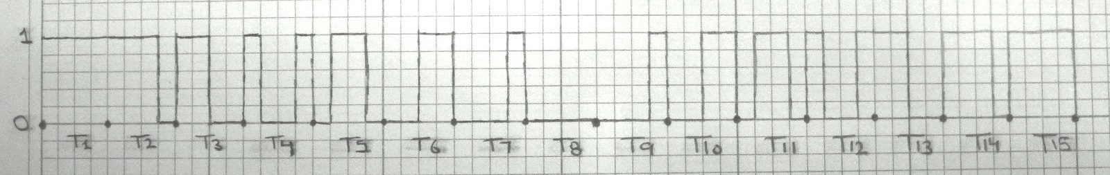

I have been given no guidance about it. The binary sequence is simply quantized bits for every sample interval. Actually I want to plot this in Matlab. Could you please help me with this? If my question is still not clear enough then kindly let me know. Thanks.

OK, that plot makes it more clear. It looks like each data sample is 4 bits, so each time slot is allotted 4 bits in serial data. Then, the entire sting of sampled data is just streamed together without any additional coding bits to help orient the receiver. You only need to decide if you want to start with the most significant bit or the least significant bit.
Let's say you had the following data ...
t_0 1000
t_1 1001
t_2 0100
then the stream would be ... 100010010100 if you use most significant bits first and it would be 000110010010 if you use least significant bits first.
Thanks.
In the plot I have the most significant bits first so I will go for it. I still see no way how to do it in Matlab. Is there any plot function for it? Kindly let me know. Thank you.
Regards
PG
There is probably a really slick way to do this, if you give it a little thought. But, a slick method is not necessary; hence you can just do a brute force method by which you pick off each bit and store them in an array.
Then, you don't want to just plot this because you'll get finite slopes on the transitions. Since you want infinite slopes on the transitions, you will need to have two plot points for every time point.
This is a case where you need to just think and figure out a way. I quickly came up with something, but explaining it without code is too cumbersome and will result in a constant going back and forth for you to understand it. So, I'll give the code because I know you will work to figure it out and understand it and not just use it blindly.
Example code is as follows, but there are many ways. This is intended just as an example of one possible method and certainly not the most elegant way possible.

The way I might do the plotting would make use of the variable 'u' that already contains all the bit data (it's simply reshaped into a vector).
x=[0:1/15:1]';
y=cos(2*pi*1*x);
q=[0:1/15:1];
z=7.5*(y+1);
w=round(z);
u=dec2bin(w,4);
% convert from ASCII to numbers, and reshape to a vector
bitstream = reshape(double(u' - '0'), 1, numel(u));
stairs(0:length(bitstream)-1, bitstream)
