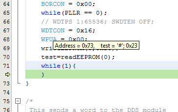

To test this we need to add a prototype and we'll use a global variable to store the result.
So, at the top of the code is,
void sendDDSword(int);
void writeEEPROM(unsigned char,unsigned char);
unsigned char readEEPROM(unsigned char);
unsigned char test;
void main(void){
test is our new variable and we can test the readEEPROM routine straight after the writeEEPROM,
    WPUA = 0x00;
    writeEEPROM(0,0x23);
    test=readEEPROM(0);
    while(1){
Now, when we compile, run and then pause the code, we can hover over the variable and see it contains 0x23,
And we know that works too.
