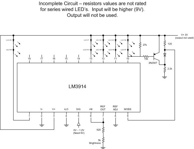

Will this work provided I can calculate the correct resistor values? I am working on this in a very slow manner and want to make sure i am on the right track.

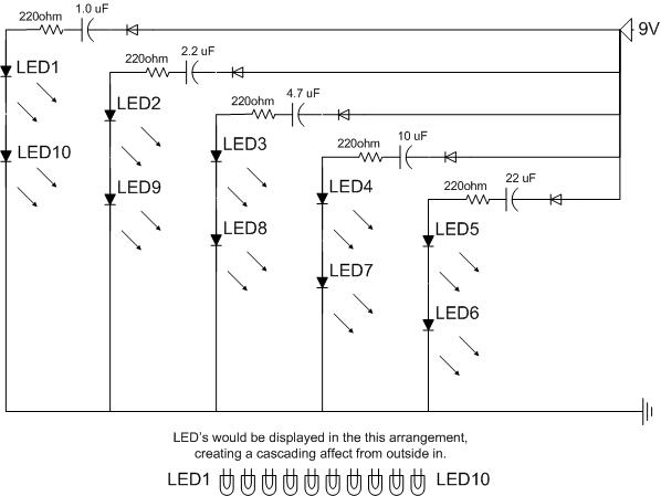

Okay since it seems the LM3914 set up will not provide enough power to run the LED's in series like I want, I went back to basics (well I very new so really I never left basic)
Perhaps this would work. It may not be the cleanest solution but if I used different size caps with the LED's in groups wouldn't the caps discharge at different rates creating a cascading sequence? The value of the caps may not be correct in my diagram but you get the idea. It may require larger variation between each cap.
Or am I going to blow myself up?

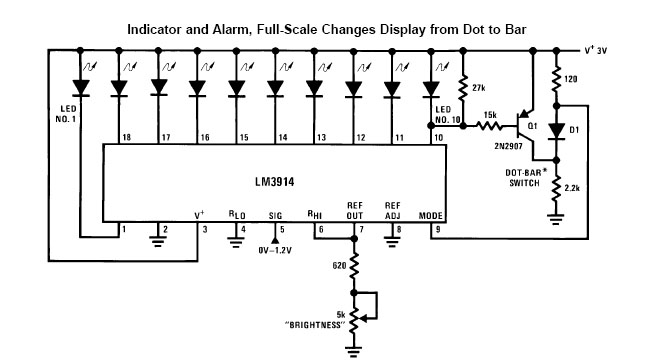

The LM3914 can drive up to three red LEDs in series on each output when it has a 9V supply. It can be set to provide a regulated current up to 30mA on each output which is plenty for ordinary LEDs. Its regulated output current does not need current-limiting resistors.
Your circuit with the capacitors would just blink the LEDs for a moment.
The LM3914 can have the 1st LED in series with the 10th LED and they would light and stay lighted, then the 2nd and 9th LEDs would light and stay lighted, then ther 3rd and 8th LEDs would light and stay lighted, then the 4th and 7th ....., exactly what you want.
Or the LM3914 can light up to 10 LEDs or up to 30 LEDs (in series) in sequence.

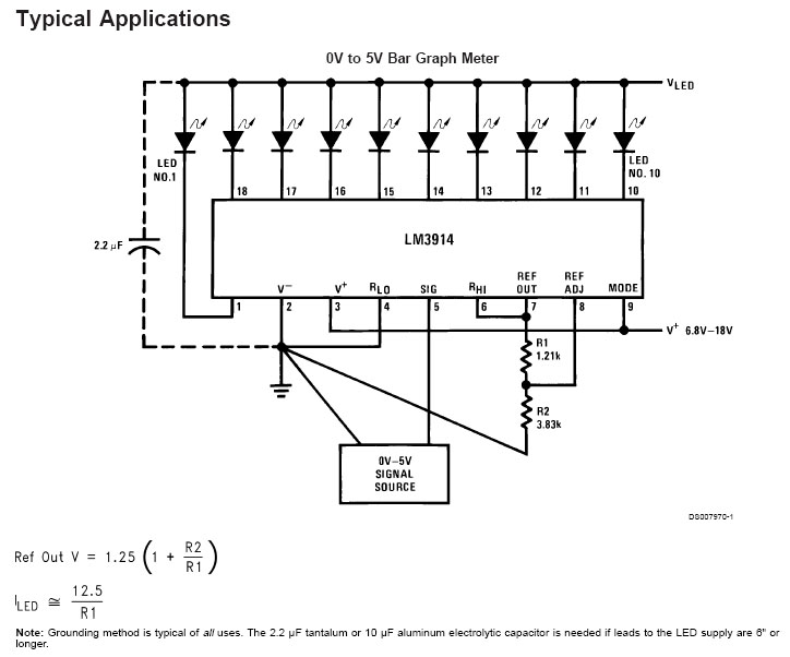

I have been playing with the LM3914 on my breadboard and I can not get it to work. I am not giving up on it but I think it may be more complicated then i can understand at this time.
I started with trying to build the "Typical Application" to understad how it works. then i was going to move on to the second application. Then eventually to your suggested application but i cannot even get the first one to work. The datasheet i found for the LM3914 helped me understand how it works a great deal and i understand how your suggestion will function but i still can't even the "Typical Application" to work.

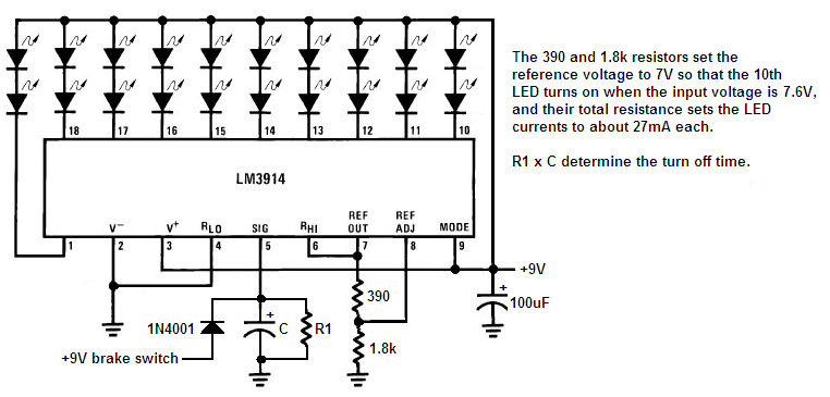

Your LEDs with capacitors will just blink the LEDs for a moment.
Make the LM3914 circuit like this:

What is the forward current [If] at the Vf of 2V?
You have a graph of Vf vs. If for these LEDs?
Most ordinary little LEDs have a max continuous current of 30ma. Their brightness and voltage are rated at 20mA.
The forward voltage is a range from 1.8V to 2.2V and a graph won't show the range.
The forward voltage graph of a low voltage LED like this is almost a vertical line.
These LEDs have a very narrow 20 degrees beam width.
Thank you for posting this I will build it up again tonight and see if I can get it to work this time.
Not to look a gift horse in the mouth and ask for more but will this work with only five sets of LED's (10 total)? At what range cap and resistor should I start with for C1 and R1? I connected it up last night with a 2.2 uF cap and a 3.8k ¼W resistor and just got a puff of smoke from the resistor. Figured it was because it was only a ¼W. What would be a good start point?
Then the 1.8k resistor will need to be re-calculated so that the 5th output is active (instead of the 10th) when the input voltage reaches 7V. Change the 1.8k resistor to 3.9k.
When the input is 9V then the 3.8k (not a standard value) resistor has 8.3V across it. The power in the resistor is (8.3V squared)/3800= 0.018W which is nothing. The resistor will not even feel warm.
The time for the LEDs to nearly turn off is R x C. Using 100k and 100uF will result in a time of 10 seconds.
