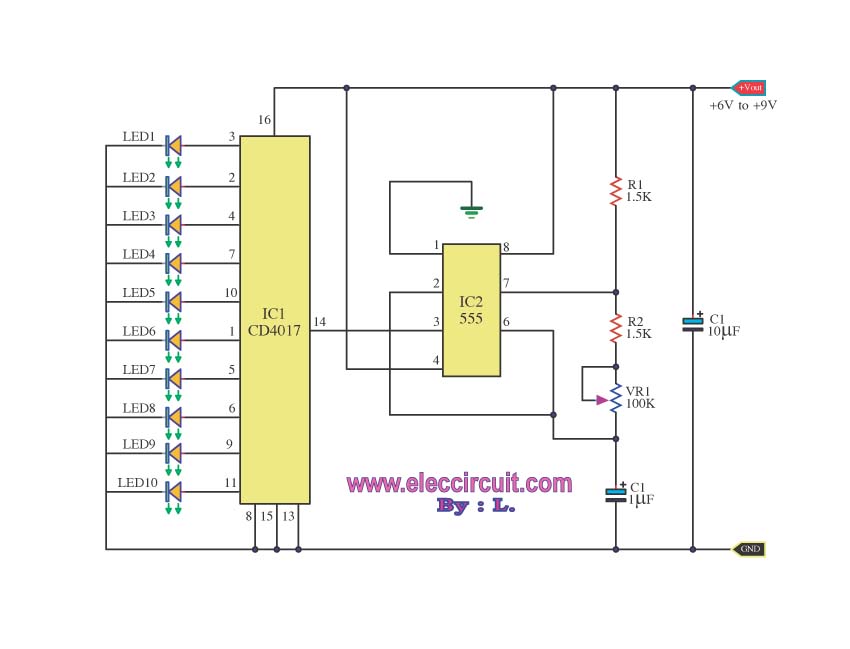

Lets start with Phase1 --Schematic diagram
Below is my circuit design copied from https://www.eleccircuit.com/led-chaser-by-ic-4017-ic-555/
Have few questions as below
1)Can the above circuit work with single AAA 1.5V battery ? if not
2)My Input is gonna be 1 AAA battery 1.5 volt. , how to convert it to 6-9volts range ?
3)Is there any best step-up 1.5v to 9v convertor schematic ?. It should be small in size and cheap in price .
4)My final out put will not have 10 LEDS , instead will have 5 LED's , is it best to use IC 4017? or do you guys have any other IC in mind .

You ask if the chase circuit will work from a single 1.5V primary cell: The short answer is, no.:eek:
(1) LM555 supply rails are, 4.5V to 16V. https://www.ti.com/lit/ds/symlink/lm555.pdf
(2) CD4017 supply rails are, 3V to 18V. https://www.ti.com/lit/ds/symlink/cd4017b.pdf
The CMOS version of the LM555, the LMC555 will operate from 1.5V to 15V though. **broken link removed**
But even though theses integrated circuits are specified for low supply rails, their performance degrade below around 5V, and the LM555 is not really happy below 9V supply rails.
If you absolutely need to operate your circuit from a single 1.5V battery, your best bet, is to use a boost (step up) switching voltage regulator. You can either make your own boost converter from a transformer (wind yourself) and a few other components or buy a converter off-the-shelf (cheap on ebay). Building your own boost converter would be an interesting exercise though.
I haven't looked at the other aspects of your circuit yet.

you need to put a resistor in series with each LED to define the LED current.
In addition, you need some high frequency ceramic decoupling capacitors: 220nf, or larger, directly across the supply pins of the 555 and 100nF, or larger, across the pins of the CD4017 supply pins.
You also need a 10nF ceramic capacitor from pin 5 og the 555 (control voltage) to 0V.
If you are using a battery, you would also be wise to increase the electrolytic capacitor on the input supply rails to 1,000uF or higher.

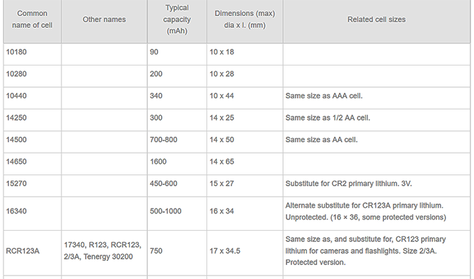

My advice for batteries would be to go for a Lithium Ion (LiIon) rechargeable battery. For small portable applications I normally use a RCR123 cell, but that might be a bit big for your application (see table of LiIon battery sizes below). A single LiIon battery has a terminal voltage of 3.6v and has a very high energy density compared to other battery types. LiIon batteries also have a much more stable voltage than the normal non-rechargeable batteries you buy over the counter.

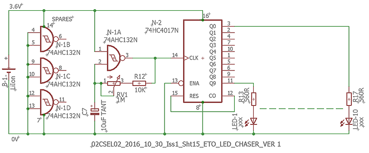

Here is a complete LED chase circuit for you to consider.
NOTES
(1) A singe 3.6V LiIon battery will power the circuit.
(2) The current consumption is negligible apart from the LED current which is set at around 2mA each.
(3) The circuit is designed for high brightness, low current LEDS but can be modified for higher current LEDs
(4) Decoupling capacitors are not shown.
(5) Both chips are DIL (not surface mount) for easy assembly
(6) The variable resistor adjusts the frequecy of the integrating oscillator and thus the speed that the LEDs chase.
(7) The timing capacitor should be a tantalum type.

No probs Jeez,
The form on ETO is that we all post circuits but it is up to you to choose the one that you want to go with.:)
(there is just one point though, the 555 is not too happy below about 7V to 9V supply lines)

And if you want to use only 5 LED's connect the reset (pin 15) to the output which would have driven LED 6.

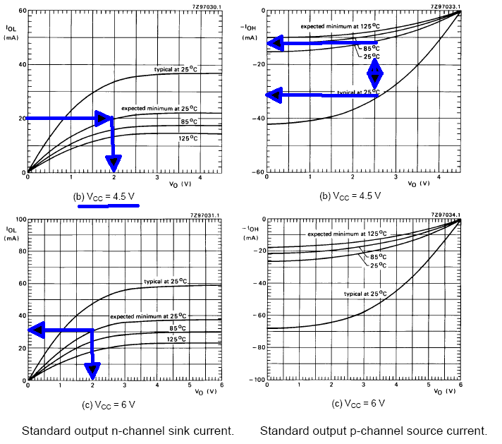

Considering the CD4017 has an output driver equivalent to 1k at 3V and 300 Ohms at 15 V, current is going to be sparse. But in spec 's improve design the difference voltage between Vbat and Vf of LED is limited in current by Ohm's Law ... ΔV/Rs=I.
So for Red/Yellow Vf=2-2.1 with Vbat=3.6V
(3.6-2)/20mA= 80Ω. and his 560Ω will last longer at 1.6V/560=2.9mA which may be enough using 10Cd 5mm Red LEDs now producing ~ 2.9/20*10,000mcd=1,450 mcd

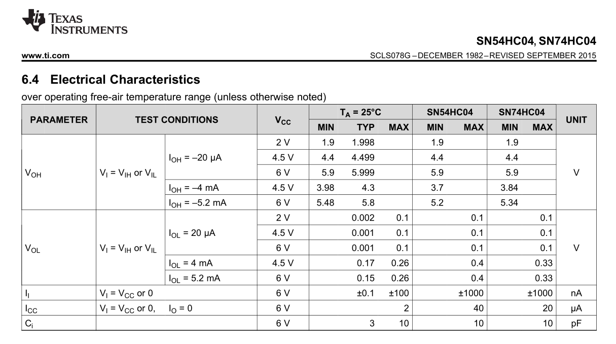

Yes, the 74HC4017 and other HC Cmos ICs provide plenty of current at 3.6V and 5V supply voltages:

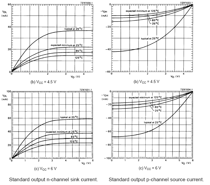

You can't say that about worst case 3.6 since it is no longer specified.
Iol min =30mA@2V (rise) for Vcc=6V @25'C or Zol=67 Ohms
Iol min =20mA@2V (rise) for Vcc=4.5V @25'C or Zol=100 Ohms
Iol min = 10 mA @2V (rise) (est.) Vcc-3.6V is no longer spec'd @3V or Zol=200 Ohms from previous datasheets, which I have it was 1K for CD4xxx but the 74CD4xxx is lower Zout
It seems they have relaxed the current specs for 74HCxxx low voltage where users must choose 74ALCxxx if they want high currents at 3.6V
There is another variable in the equation now: Texas instruments have dropped HC for many of their CMOS logic chips and moved on to AHC, for most functions, but retained HC for the 017 decade counter.
AHC has twice the speed of HC and half the power, and I think the output is tailored to reduce ground bounce.
As a rough rule of thumb, it seems that at 25 Deg C junction temperature and 5V Vcc, HC and AHC can source and sink 8mA, worst case.
In practice though, the maximum source and sink currents for CMOS logic chips seems to vary widely from manufacturer to manufacturer and batch to batch.
