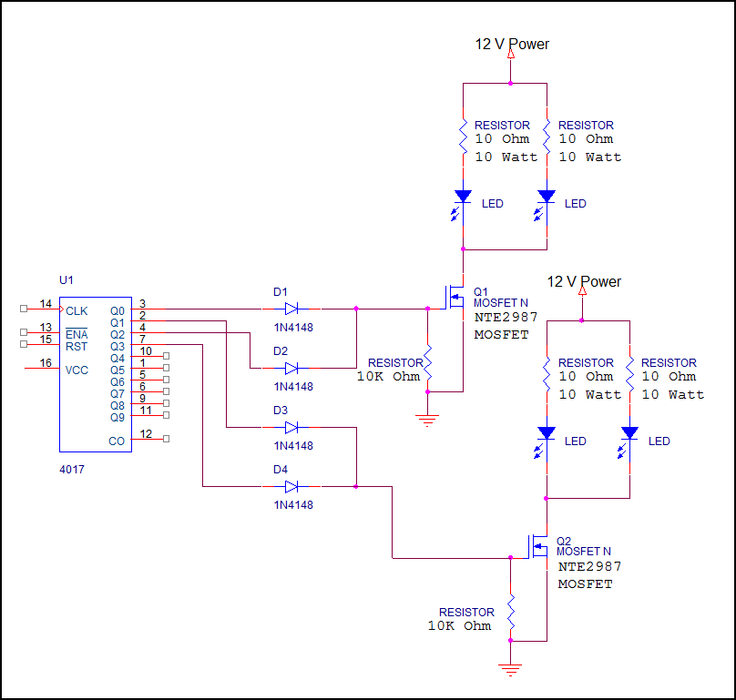

Actually I'm looking at a similar sort of thing, I have the circuit to do the chasing but I want to use some very high power led devices with the circuit The high power LED's provide over 1000 Lumens light output.
How do I do this the supply power for the whole thing will be 12V car battery (My 4x4)
The LED devices use between 10V-12V DC power is 1000ma to 1500ma per LED device directly. I want to use 2 High power LEDs per output from the led chaser CCT. I really want to be able to put 2 outputs per pair of LEDs driven (that would should give a double flash)
Anyway I figured the foundation would the typical led chaser circuit with your typical low power LEDs in it and then drive FET or 2 per 2 outputs (double flash) flash would be variable as that is controlled by the led chaser circuit. each channel really needs to go hard on and hard off per channel.
I would like to be able to turn on a FET or FETs or Transistors or similar with the output from each low power output that normally drives the low power leds or more to the point 2 of the outputs (double flash) for these high power LEDS, the amount of current per output could be as high as 5000ma. I figure a 10 channel led chaser circuit would be able to say drive 5 channels x 2 high power leds per channel to get the my desired result.
I thought adding a simple addon circuit would be the way to go that way it is expandable as might be needed.
I am unfortunately no good at designing this stuff but I I can build it that I can do
Could anyone offer or provide the extra circuit/s that would make this add-on work with the traditional led chaser circuit please.

Yes that looks like what I'm after (Chaser Circuit), just one thing to get the double flash is it better for two outputs from the IC or use 2 FET outputs to the High power LED's.
The high power LED's use 10V - 15V and upto 2000ma typical light out put around 1000+ lumens, there will be 2 maybe 3 in parallel per channel (5 Channels) and they will double flash. I'm not sure how close I want the flashes so that will take a bit of fiddling as to which outputs are used for the double flash.

I am not sure what you have in mind with this "double flash" term?
The way the thing works is the 555 timer is functioning as a clock. For each positive going clock pulse the 4017 counter advances one count up. Placing a few in parallel won't be a problem as the MOSFETs will handle the current. Do you have a part number or link to these LED assemblies?
Ron
Ron
Rather than connecting one output use two different outputs say 1 & 3 from the LED chaser circuit to one input of the FET so that the high power LEDs flash twice with a longish pause before those particular ones flash again thats all.
Obviously there are other ways of doing it but this is about the most robust way I know of that is also scalable as well and no programming at all.

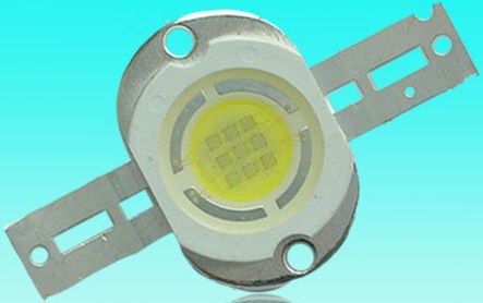

Um No part number for the LEDS I have attached a picture of one though
And the specs for this particular one are
Color : White
min 800 lm, max 1000 lm
100 to 110 deg angle
Forward Voltage 10.0 to 12.0 VDC
Forward Current 800 ma to 1000 ma
and they do need a heat sink but that's OK for my use.

I would use this mosfet or any mosfet like it. I placed 10 Ohm 10 Watt resistors in series with each LED simply for current limiting reasons and since you plan to parallel several. I only show two pairs.
The circuit is a cut away version of the circuit I posted earlier. I would run the basic circuit off 9 volts. You can use a LM7809 regulator to get 9 volts from the 12 volt system real easily. I would filter the in and out of the 7809 with a .1 uF and 1000 uF cap on each side.
Anyway, I believe the attached is about what you are after.
