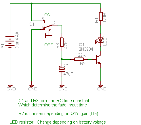

Since I have nothign better to do (day off work right here lol) I thought about the simplest way of doing this....whilst being a good bit of education for those who are complete novices.
It's a simple circuit that uses a transistor, it DOES require a dual toggle switch...which your flashlight may not have, but it does exactly what you require, and allows you to determine how quickly it fades in, and fades out when you turn it on/off. Its just a question of part values. Great introduction to basic analogue electronics...you can tinker with part values to see what each part does and its affect on the LED.
Probably overkill, but hopefully it can be of some use to you guys, especially if you can learn something new.

The problem with attempting to use RC constant to gradually fade a LED is that RC constant is more involved with the time required to reach a particular voltage, rather than with gradually reducing or increasing voltage.
For instance, a 1Meg resister and 2.2 uF cap would, by formula, produce an approximate 2.2 second delay in either charging or discharging the cap. However, when the LED turns on or off during this charge or discharge depends on when there is sufficient voltage to turn on the LED, or insuffiecent voltage to sustain the LED's operation.
RC constant, very simply, is the time it takes the cap to charge to 2/3 applied voltage, or to discharge to roughtly 1/3 the voltage it was charged to. During this fluctuation, the voltage point at which the LED turns on or off is reached of a sudden, not gradually.
blueteeth:
it was lengthy but very informative. i wont mind learning those as long as it could be a step in making an idea into reality. and i got the concept...well, pretty much of it. :D
thanks for the diagram, i can tinker with it for a start.
schematics and graphs are welcome. do scrimp on the math though! haha!
