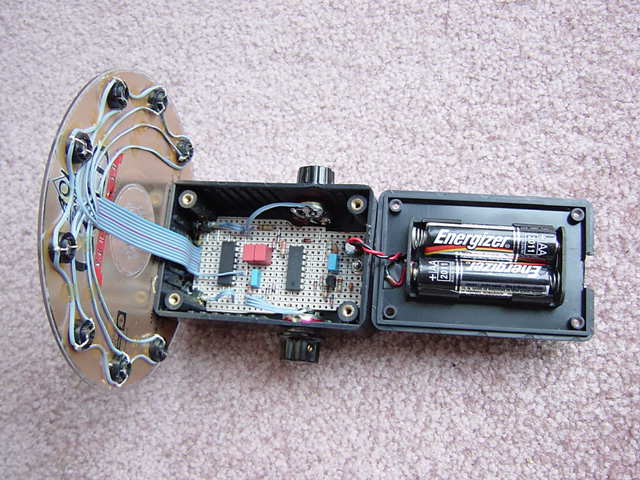

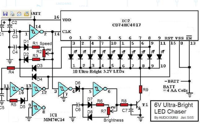

My 6V Ultra-Bright Chaser project is blinding, has speed and brighness contols and its 4 AA cells seem to last forever. Its circuit with Cmos gates and oscillators (PWM for brightness control) use such a small supply current that there isn't an on-off switch. Since the LEDs are chasing around in a circle, they make my projected shadow move around too. The project is here: https://www.electronics-lab.com/projects/games/004/index.html
hmmm
without R9 your battery would last even longer..no ?
Hi Willi,
Sure the battery would lst longer because without the current-limiting resistor R9, then IC2 would burn-out and the LEDs wouldn't light anymore! :lol:
IC2's max continuous output current rating is 25mA. Even though I have the outputs pulsing and not continuous, I always design things conservatively.
R9 also absorbs the difference in voltage when the battery is about 6.4V when new, and when it is 4V when it needs to be replaced. At 4V my chasers are still pretty bright. :lol:

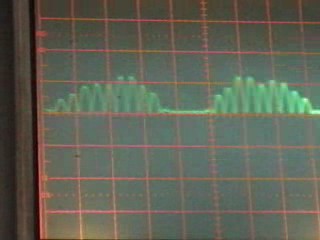

thats sort of what i ment ..but what i really ment was ,couldnt you control the amt of current flow with just a transistor ?
also i am thinking of just using two LEDs for the flash light ( torch light )
the input currentwould be limited to 100 mA for around 60 mS per pass..
the photo is the open circuit voltage 5V/div @ 10mS/div of my shaker tube output..
when i hook it to a analog meter and * shake * , i can keep it around 100 mA ..
so you see why i am trying to squeeze as much from my driving circuit as possible..
so i was thinking of using pulse width modulation and a LC oscillator ( underdamped) !! ? :lol:

A current meter is a dead short to the voltage. A red LED needs about 2V at 20mA, plus more voltage for a current-limiting resistor in case you shake it too fast. Can your shaker provide it? Maybe you should have a full wave rectifier bridge across the coil to double the blinking rate and protect the LED from reverse voltage. :lol:
i had a full wave bridge across all four coils yes..
as you know ,that is the only way to get the meter to register anything..
now , i was also thinking of using FETs instead of diodes , because of the voltage drop required to get anything out of the diode bridge..
I just ran another test and am getting a little over a volt (scope reading ) when i hook the diode bridge output to the Ammeter , which by vigorous shaking just reported just under 125mA..
I don't know why you have 4 coils, one is usually enough. I don't know where you measure 1V which isn't enough for an LED.
Just put away the meter and connect an LED. Are the flashes bright enough? Add a big filter capacitor and see if the light is smooth enough.

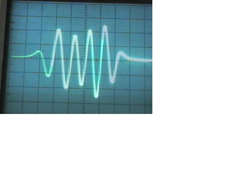

this is the output from the shaker with the output of the bridge rectifier connected to my crappy ammeter..
the pic header is supposed to say 1 Volt /div @ 20 mS /div
