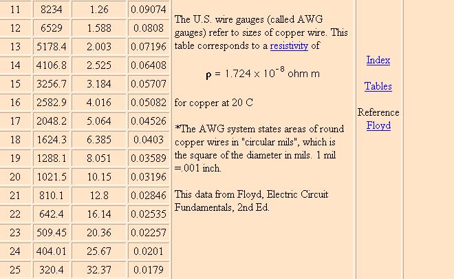

i have a LOT of 18 awg single strand coil wire 0.040 '' ...
i was using a thinner wire ..
the 18 awg is only 6.385 ohms per 1000 feet..

Since i also have a bunch 22 awg & 18 awg wire i can wind up another set of coils pretty easily..
although 20 awg would be perfect i dont have any..
the center column is the resistance /1000 Feet.
the far right column is the diameter..

so i suppose 23 ohms is too high..??
