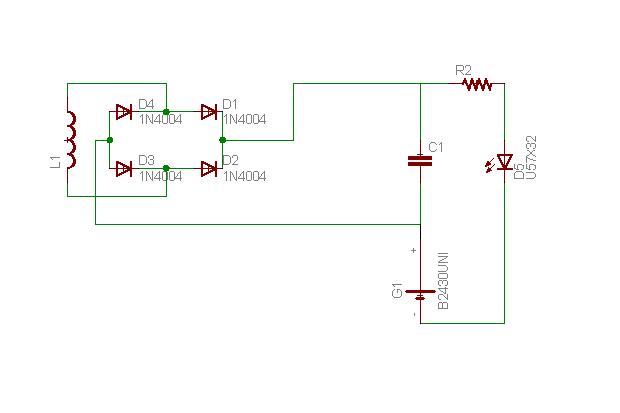

i found this relationship on a ultra capacitor site. maxwell i think..
t=CV/I , a dirivation of Q=CV..
@ I = 10 mA and 2.2 F worth super caps.. and 5.5 V
should give 20.16 min. of light
and 4.3 sec of charging @ 300mA..
the white led is pretty bright at 10 mA..
If you use a constant current circuit (that needs extra voltage) for the LED, after 10 minutes the cap's voltage will be down to 2.75V, won't it?
The LED might be powered for only 5 minutes.
I think your generator's current was measured shorted, with no output voltage. I think the current will drop exponentially as the cap's voltage rises during its charging, causing the charging time to be much longer.

EDIT:: ok i was right the first time it is 2.75 V Peak @ over 250mA..
The cap will charge with average current, not peak. You will be shaking until your arm falls off! :lol: :lol:

The max voltage for the super-caps is 5.5V but your shaker puts out 15V.
How are you going to limit it?
TI used to have a low drop-out current source IC but I couldn't find it. What are you going to use to regulate the LED's current as the cap's voltage falls when it is discharging?
i was thinking of a PIC driving a constant current source with PWM ..

I finally connected all ten .22F caps together , in parallel, for a total capacitance of 2.2 F.. :shock:
G1 is two NiMH batteries at 2.26V :: NOT enough to light the led , by itself..
R is 280 ohms
after charging them up to 5.5 V and after turning on the switch , the initial current was 15 mA..
After 19 min. current was 4.5 mA
After 20 min. current was 4.2 mA.. still plenty bright..
that is with out blinking , at all..
it took 3min 22 sec to charge them up to 5.5 V
