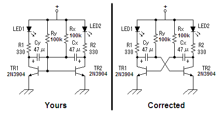

Ok so i found this led flasher circuit online ---> Simple LED flasher circuits
And i built it in eagle cad ---> **broken link removed**
But the thing is when I built the circuit all it does is light up the two leds and not flash them. Can some one help me with this circuit? I think their is a short circuit between the two transistors and the capacitor shown in the diagram but i figured thats their on purpose
You show the pcb layout.
Post the schematic with part numbers instead.
Well the parts are just two 2n3904 transistors
2x 10uf 16v caps
2x leds
2x 330 ohm resistor "the ones on the left and right"
2x 100k ohm resistor "the two middle ones"
and it does not use any micro chips
It will not work when it is wired the way you wired it.

It will not work.
It looks that both Q basis are connected together.
Good I'm glad it works.
Just a suggestion: you can get rid of the wire link by routing across the resistors.
I always try to avoid bridges because it saves soldering.:D
