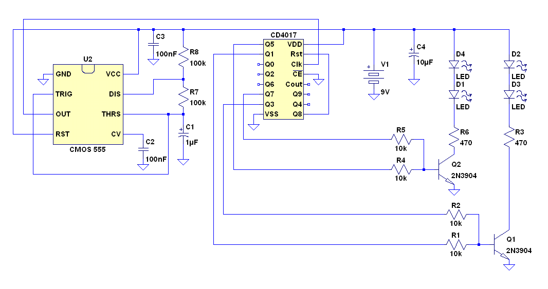

There were a couple of discussions about blinking an LED twice then blinking another LED twice, for toy police cars.
A circuit used an oscillator driving a CD4017. The 1 and 3 outputs of the CD4017 had diodes to a transistor to blink the 1st LED, then outputs 5 and 7 had diodes to another transistor to blink the 2nd LED. then the 8th output of the CD4017 made it reset.
EDIT: The IC is a CD4017.

Use a 4017 IC driven from a 555 IC or eq. to make it receive clock pulses.
Put on all 4017 outputs blocking diodes, set the light sequence with additional diodes after the blocking diodes, then drive the output transistors and led's as required.
If you make the LED current really high then they will blink as brightly as strobes, maybe even with a bit of smoke. But only one time.

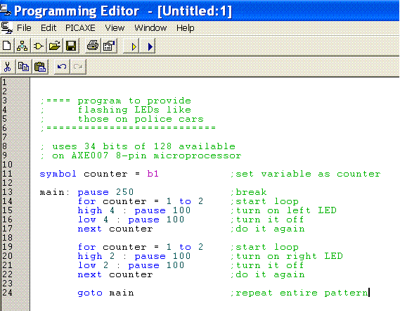

Hi, ste1070
If you are interested, attached is a simple program using PICAXE that will do exactly what you desire. Programming a PICAXE is probably the simplest of all, using the free Program Editor and a simple three-wire RS232 cable.
After you are through programming, simply mount the 8-pin AXE007, two resistors and the two LEDs, plus three AAA cells into your model car and have fun!
See also: www.jrhackett.net
Hope this helps.

If you want a solution that doesn't involve a microcontroller, here's a schematic of what Audioguru described. You can tweak pulse widths and LED currents to suit your needs.

Not that I'm pushing PICs, although I am rapidly becoming attached to them, just compare the attached schematic with that of Little Brave and Nanuk of the North.
1. Fewer components (count 'em)
2. Less construction time (even if you count programming time)
3. Less chance for error
4. Possibly longer battery life
5. Even a dummy like me can do this
AllVol

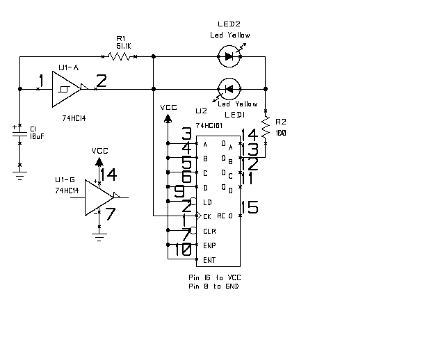

Could have fooled me. A 74AC14, A74AC161, 3 resistors, and a capacitor will do it if you do not care about the pause between the color changes and can supply 50mA to the LEDs.

That's still more parts than the microcontroller solution. Why don't you step up and provide a schematic, anyway. Talk is cheap. :D

The PIC costs more and does not provide the current for an impressive flash. Be that as it may, perhaps I will when I get home from work!
D.
The 161 is a 4-bit binary counter. My question is how are you going to get two flashes on one output, then two on another, without a decoder?
hmmm it did not link the upload...
