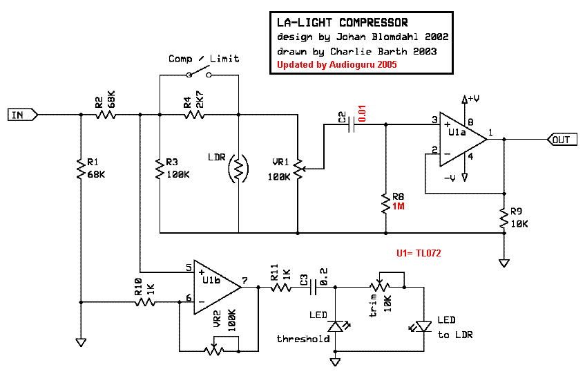

i have an amp using the lm386, it amplifies the signal, which is sent to speakers and leds, the speakers are fine, its just when i don't want my music loud, i dont see the lights, i was wondering if i could add a transistor circuit with a pot (to control sensitivity and not the volume) in between the amp and the LED's to boost the current or voltage of the signals ONLY for the LED's

You could add a compressor circuit which automatically reduces the signal's gain to the LED when the signal is loud, and increases the gain when the signal level is low:
thanks for that, what is the LDR for?
Is there a simpler circuit that just increases the current or voltage and i can use a pot to manualy adjust the increase of current/voltage depending on how loud i have it?
It is part of the automatic volume control.

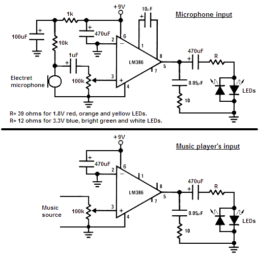

Why not use your audio amp for audio and make another circuit just for the LED? Then the LED will always show the music without being affected by how loud you have your speaker. Both amps have their own volume control and connect to the music source:

i'll try that again, i was trying to avoid doing that because i tried thar circuit for ages, it worked on the breadboard but when i soldered it, it didnt..... i gave up in the end and baught the ready made one: **broken link removed**
My 2nd circuit to drive 2 LEDs is extremely simple. It should work fine and do what you want.
i tried the 2nd one... no luck :( i think i'll but another amp module lol
Even if i do get it working on the breadboard, its not going to work when i solder it!!! lol

Sorry if this isn't 100% relevant, but what does the 10uF capacitor do in the "microphone input" circuit?
Hi Digitan,
The 10uF cap across pins 1 and 8 0f the LM386 boosts its gain from 20 to 200 so it is sensitive enough for a microphone.
