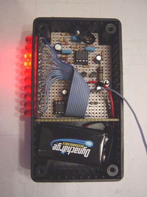

My new Sound Level Indicator project:
https://www.electronics-lab.com/projects/motor_light/009/index.html
has an LM3915 driving 20 LEDs in 10 steps of level. It has automatic-gain-control so it usually indicates conversation voice levels but cuts back to show the beat of the music.
