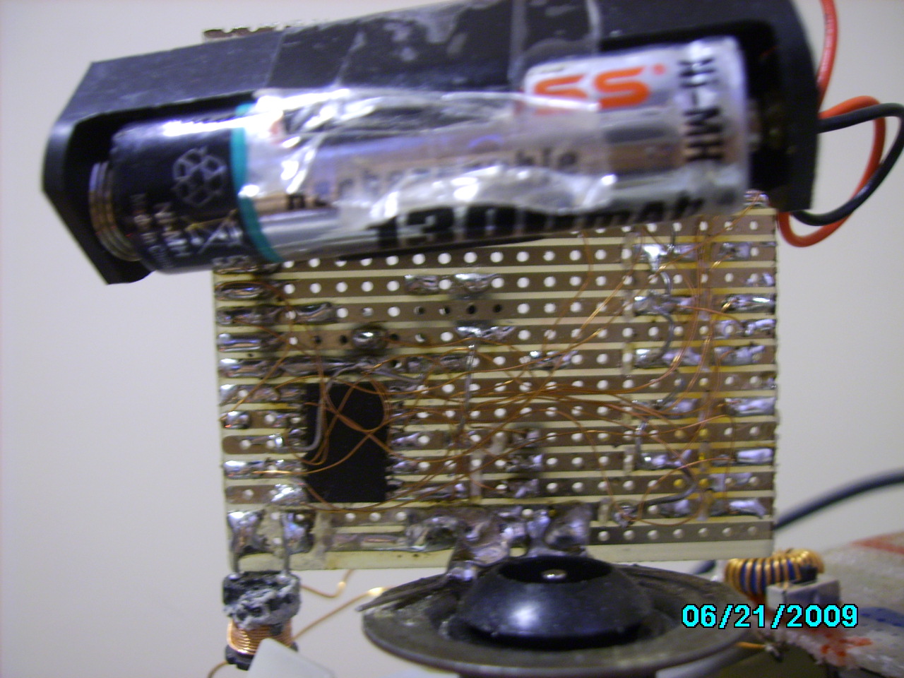

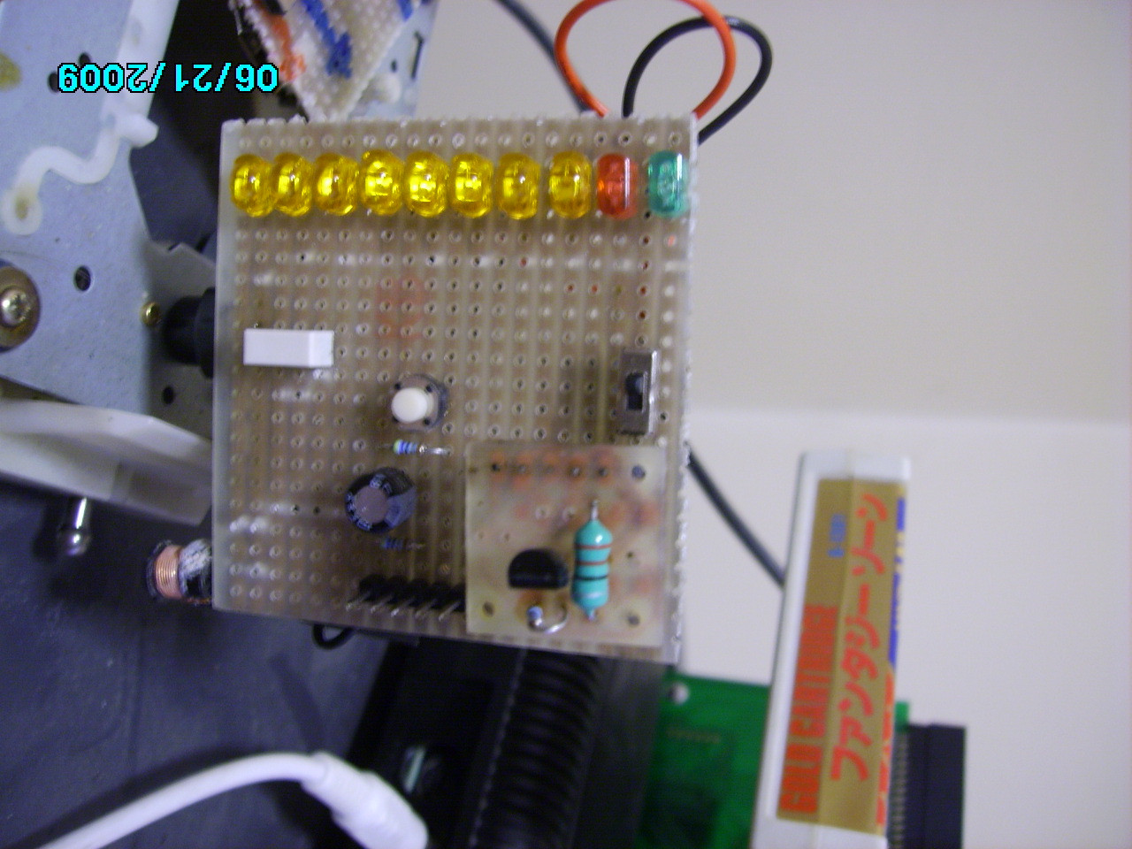

they are popular circuits.
in the past I have tried to build them with less and less parts, and also for lower prices.
here a 16F54 flashlight.
I've used a 5MHz resonator as clock source.
the LEDs are wired 1:1, without any resistors.
power supply is via DC/DC converter (the tiny hookup PCB),
one single AA battery. it lasts about a week.
now I have already mounted it on a CD-ROM tray, in order to make a persistence effect display!
i tried 3.3 volts for the motor.
it is too slow.
the battery is also rotating!
the schematic is very trivial, just connect LEDs to the port pins.
if interested I can draw it, and also make available the source code.
I know it is a trivial circuit, but maybe it is useful for someone.
