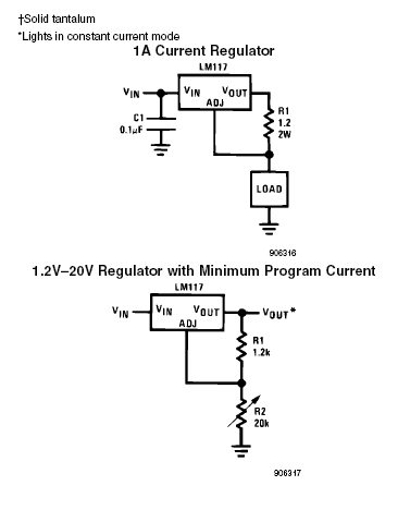

Went and picked up a LM317T. And I guess by what this says I need a 9 ohm resistor.for the 2 leds.Is that correct ? and to light 3 in series I would need to use a LM338T because that could take up to 5 amp. I didn't figure out the resistor for the LM338T yet.

We do not know what you are talking about.
You and we do not know if your LEDs are 2.7V or 3.7V or in between.
If they are 2.7V then three in series need at least 8.1V plus 3.2V for the current-regulator circuit. Use Ohm's Law to calculate their current or to calculate the value for their current-limiting resistor.
If your LEDs are actually 3.7V each then their total is 11.1V and they still need at least 3.2V for a current regulator circuit. Do you have at least 14.3V?
If your LEDs are in parallel then show your schematic.
5A is a lot of current. What are you doing with it? Burning out LEDs?

The spec's for your cheap Chinese LEDs do not have enough detail for you to use them in a simple circuit.
You should use Name-Brand LEDs that have guaranteed detailed datasheet spec's.
Why do people buy cheap junk?
I see some 'smoked' LED's in his future.
The best way to drive these high power LED from a battery is with a switching power supply that produces constant current.
If you do it the simple way with dropping resistors then keep at least 25-30% overhead voltage drop across current limiting resistor.
This will be painful as the resistors will generate significant heat. Also don't forget the LED's need their own heat sink.

If the led drew 3 volts, and a car battary usually is 12 to 14 vdc, I cant see why I couldn't put 5 in seires that would be 15v.
An LED does not draw 3V like a light bulb. Instead an LED draws as much current as it can until it burns up if nothing limits the current.
They cannot make LEDs with a precise voltage like a resistive light bulb so each LED has a different voltage (2.7V to 3.7V). Since an LED is a diode then its current changes a lot if a varying voltage is fed to it. The current will be way too high or will be nothing.
Therefore you must limit the current or regulate the current.
This is from National's data sheet.
LM317 can be used as a voltage or current regulator.
The LM317 tries to make 1.25 volts between ADJ and Vout.
In current mode it will sent current to the load (LED) untill there is 1.25 volts through the resistor.
1.2 ohms = 1 amp
12 ohms = 100mA
The regulator needs Vin to be > Vout by a couple of volts.
The LM317 will get hot so add a heat sink.

I hav tried above circuit n found that along with constant current this circuit also provides sufficient forward vltg for almost 4 LEDs......... this one is good
