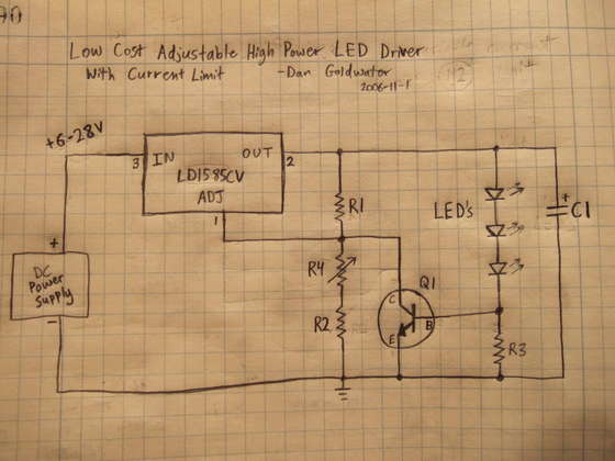

Would something like this https://www.instructables.com/id/Super-simple-high-power-LED-driver/ added to the circuit help to avoid overheating?

The LM317 as a current regulator is what I often recommend but you'll still need some heat sinking for the LEDs, possibly just some large copper areas on a PCB.

Will something like this the-analog-adjustable-driver.jpg work to be able to control the entire system? Or is this guy missing parts too?
