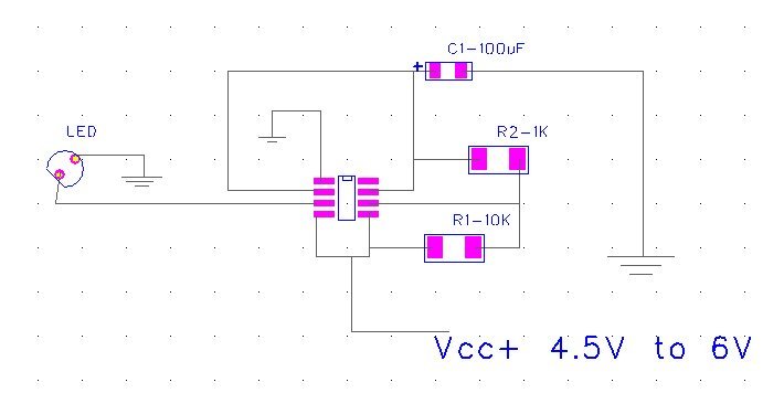

LED is not flashing using 555
It could be any number of problems, eg:
The 100uF polarity is reversed.
The 555 is incorrectly wired, etc
Please post a clear picture of the project so that we can check your connections.
You may need more than 4.5 volts supply, thats right at the min spec. Try 5 volts.
I have simulated the original circuit and it works like a charm.
Check your pin count. Something is very wrong with it.
IC pin count starts at pin1. Left hand bottom pin and follows to the max pin number in an anticlockwise pattern.
So if pin1 is at left hand bottom pin8 must be at left hand top.
You obviously fried your chip. Time to use another one and do it right this time.
Boncuk
Looks like the pins on the right hand side are wired upside down. Power should go to pin 8 not 5. You should put a cap on pin 5.
Andy

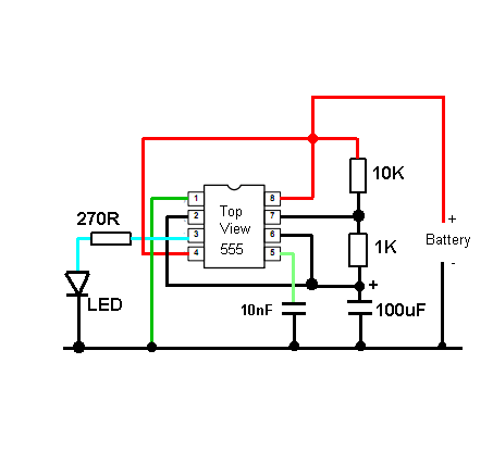

Try this very simple layout, as I said earlier the 555 maybe faulty.!

Oh god. Thank you Eric and Boncuk. I were wrong in pin Count. I'm very beginner to Electronics, Thank you Eric for the Circuit...
Thank god. My IC is not damaged. Maybe I gave only 3V for wrong connection. Thank you Eric, The circuit you gave i used. It's working. I happily finished my first project... Huhuhu...!
