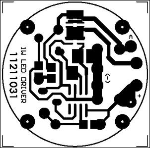

The pcb layout in the Silicon Chip magazine project looks like it has the high current paths separate from the sensitive ones. 8)
The silicon chip magazine's PCB is not the correct size at all. In my PCB the track sizes are also much bigger, mostly .032". The different loops are also kept away from each other.

So, im having absolutely NO luck with the PCB. It only seems to work on the breadboard. The two PCBs that I have created for this project have not worked at all.
I want to use the one from the chip-torch article, but i cannot figure out how to size it down to the right size. Whenever I try, the quality becomes terrible. Can anyone get it to the right size? I have tried changing the file formats to .gif and .bmp, but the same thing happens.
What is irfan view? Is that what you used to do it?
Oh yeah, i just realized it would be impossible for you to give me the right size without actually printing it out and stuff. ill have to do it on my computer.
