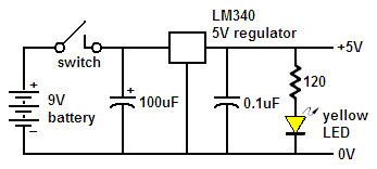

I only understand I need a 120 ohm resistor. Can someone explain this whole resistor thing, and what it does to everything, and what it does to the britness of the LED. DO I hook up the resistor to the - or+ of the LED, is there a + or - on the resistor?
Sorry for asking questions, I just...want to know.
The resistor in series with the LED limits its current. Its max allowed current is about 30mA. It is a very old LED so it isn't very bright at 30mA. At less current then it is less bright. A higher resistor value reduces its current.
The 9V battery does not have much capacity. Its voltage drops as it quickly runs down. The 5V regulator needs a minimum input of 7V so measure the battery voltage frequently and replace it frequently.Six AA cells in series have 5 times more capacity and cost about the same as a 9V battery.

You lost me at the ciruit drawning.
How do I hook up the 120ohm resistor.
And, I would get 6 AA, but I cant fit that into a portable altoids tin.
My circuit is drowning? My drawing? It shows all the parts that are needed, their values and what connects to what.
My drawing shows one end of the resistor is connected to +5V and the other end is connectd to the anode of the LED. Solder them together.

Does the resistor have a + or a - side?
No. A resistor is not polarized. Both ends are the same.
Which side is the anode? The long or short one.
The short wire on an LED is its cathode. The rim of its case has a flat part near it.
Why do you have the .01 UF and the 100 UF in there?
My drawing doesn't have a 0.01uF capacitor.
Regulator manufacturers recommend an input capacitor of about 0.22uF and an output capacitor of 0.1uF. For some circuits a 10uF output capacitor is best.
I increased the value of the input capacitor to 100uF because a little 9V battery is weak and the 100uF filters it well.
In your drawing you have a 100 uf, then a .1 uf, then a 120 resistor.
So, let me get this straight, I just need to connect the 120 resistor to the + of the LED(the long one)
kaspar389 said:
So, I dont need all those other resistors( the .1 and the 100uf)?
They aren't resistors, they are capacitors.
The manufacurer recommends them and all circuits have them. Yours should also have them.

There are a few 'MinyBoost" ipod chargers or extra battery circuits on the internet. One says it doesn't work. Most are "instructables" with no schematic or errors on their schematic.
The best ones use 4 AA Ni-MH rechargeable cells that last a long time and don't need a voltage regulator (4.8V to 5.0V).
!! I got the 100ohm and 2 10ohm resitors(RS didnt have 120ohms) so now it works. I just used a 9v. It should be fine..cause, I didnt want to have a big box, i wanted it portable.
