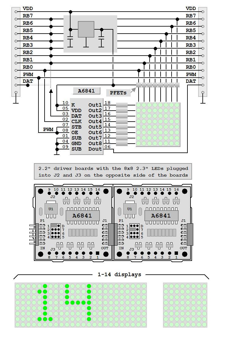

How about modular boards that allow you to put together any size matrix? You've probably seen the modular 8x8 design below before... Instead of putting all of that logic on each board, just put a 20 pin dual row connector. The important thing would be to design the boards in such a way so that they could be mounted onto a frame with no LED gaps between boards.
That is exactly what I had in mind Mike.

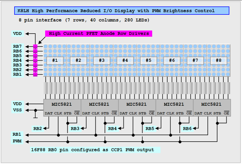

Here's another design for your consideration. You could certainly use discrete LEDs instead of 5x7 matrix displays. And, populate it with LEDs and drivers as you see fit.
