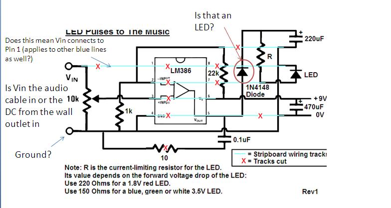

Alright, I am constructing your circuit shown here from a previos thread and I have a few questions. I put them on the drawing for easy reference. I fogot one...Where do you plug in the audio cable so music comes into the circuit?

Can you link the original version and thread of that diagram? It would be easier to explain it to you if I could see the original.

My circuit is shown made on stripboard. Stripboard is perforated and has horrizontal strips of copper that connect some of the parts together. The blue line are the copper strips. The red X's are where the strips must be cut (with a drill bit) so that the wrong parts do not connect together.
For example, pin 1 of the LM386 must not connect to anything, the same with pin 7 and pin 8.
You circled a 1N4148 diode that is not an LED. It should be a 1N4001 diode when you drive 6 LEDs.
The Vin is the audio input. You correctly found the input ground. the +9V and 0V are the 9VDC battery or power supply.
The 10k pot is a level adjustment trimmer.
My sketch shows only one LED and the current-limiting resistor for it. Add the other 5 LEDs and current-limiting resistors to the same connections.

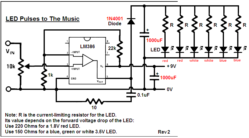

Can I connect all 6 LEDs in a series with a single resistor totalling the sum of the LED R's (I calculated 1040 Ohms, but Im only using 1K with a 5% variation, so 950 to 1050 Ohms)?
Red LEDs are about 1.8V each.
White LEDs are about 3.5V each.
Blue LEDs are also about 3.5V each.
If they are in series then their total voltage is 17.6V plus about 25V for the 1k current-limiting resistor so the drive signal needs to be +42.6V which is much too high for the LM386 amplifier IC.
So will I have to build a seperate circuit for all 6 LEDs? Im trying to fit this project inside a model car 1/24th scale, so about 10"x4" and 1" tall. Is it ossible to put maybe 2 reds on one circuit, 2 blues on another, and 2 whites on a third? Or could I mix and match? (Basically, what would be the most voltage I could put on the LM386?)
Oh, and what is the ground for the audio cable. I was going to cut a standard 2 chord headphone/audio cable with L and R channels, is a certain one the ground and the other the Vin?
Two 3.5V LEDs in series need 7V plus 2V for a current-limiting resistor plus 2V for the LM386 headroom and diode. Then the total supply must be at least 11V. The datasheet for the LM386 shows its max allowed supply is 12V for some of them.
You will not find a 12V battery that does not drop below 11V that has enough current in the tiny size you want.
Connect the LEDs each with its own current-limiting resistor. Then the highest voltage LED is 3.5V plus 1V for the current-limiting resistor plus 2V for the LM386 headroom and diode. Then the minimum battery needed is 6.5V and a 9V battery will work for a while.
Headphones have a left signal wire, a right signal wire and a ground wire. Feed the two channels through two series 1k resistors that join at the volume control for the LM386. Connect the grounds together.

Make it like this and use a 9V adapter:
