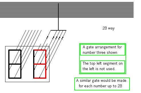

I am interested in building a small LED readout for notifying me when a transistor on a circuit board has been pulled to ground.
Let me explain a little.
I repair pinball machines and video games. I have a test fixture i have built for testing the pinball circuit boards. I have 28 TIP102 transistors that are used for turning on and off coils on the machine. All 28 transistors are labeled say Q1 - Q28. I want to make a small two digit LED readout that would light up the number of a transistor when it is activated or even shorted. The transistor itself when turned on completes the path to ground for the coil. Im my case i will not have the coils hooked up. I just want the outputted ground signal to light the LED to the associated transistor.
Example Q23 is shorted, or activated by the built in test software.
I want the LED display to read Q23.
I know the "Q" will be a given and i can fix 14 segment LED readout for the letter "Q"
What i need is a way to light the proper number from a single ground.
Any Ideas? Or any Related WEB pages?

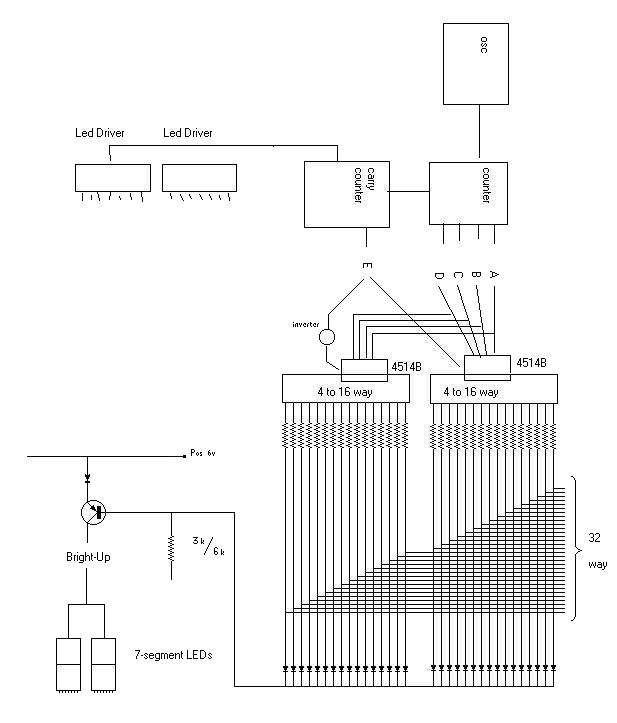

The suggestion is to run a free running oscilator fairly
slowly say about 6 c.p.s. and feed a binary 5bit counter
with it to get a 5 bit output A, B, C, D, E, to run
through the 5 binary outputs at about every 5 secs
roughly.
The 5 bit binary output would be used to drive the two
demultiplexers, using the 5th bit to switch between
the two, to give a 32 way rolling output signal,
Also this 5 bit binary count would go to a counter
section made to drive two 7-segment displays.
This arrangement would refer each of the 32 outputs to
the same count on the 7-segment display pair, which
would not be showing, it would be 'Dimmed'
In the event of an output encountering an earth fault,
the 7-segment display would 'Bright-Up' for about a
quarter of a second. If thats the only earth fault,
the same number would bright-up every 5 secs or so.
If two or more earth faults are present, then the
display would show each, as it occurred.
I'm trying to see an easy way to make the display stay
until the next signal, which may be the same number,
if its a different number, i'm wondering if it could
be made to change and display the next number.
This would get a bit silly if there were too many
numbers, but i think a repeating display of a few numbers
might not be confusing, if its not to fast so they are
each legible, i guess it would be unlikely to be more
than two anyway.

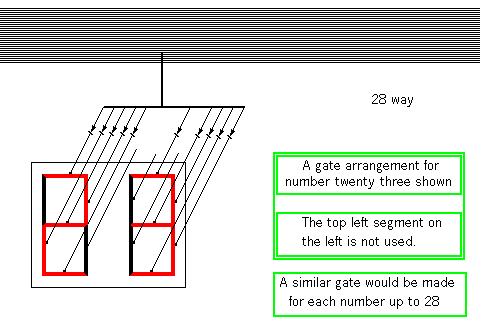

Just figuring out which way round the diodes would go
has worn me out! ive shown the 28 way as a 32 way, that
doesnt matter, the extra ones wouldnt show as earth
leakage.

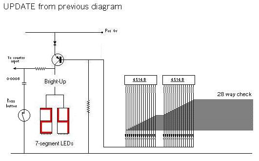

In the diagram presented here,
i have assumed 32 wires going out to the unit to test,
each being a possible earth fault.
They are each in turn presented with an output from
a 4514B chip, with no interval in between each.
Where each outgoing wire has no earth fault,
then the base of the associated transistor will see
a high level, typically 90% of supply voltage, in this
case 5 to 6 volts, being supplied by the outputs of
the two 4514B chips.
The outputs giving a 'High' each in turn, with almost
no discernable gap between each taking its turn.
If however, one of the outgoing wires has an earth
leakage problem, then when that particular wire has
the voltage presented to it via the resistor from
the output of the decoder(4514B) it will show up.
It will show up because it would not go 'High' like
the others, and the transistor would operate.
The diode in the emitter may not be needed,
its only in case the 'High' is not high enough to
shut the transistor, but it usually is.
When the transistor operates, it puts a supply to the
7-segment displays, or maybe the Ch.En on their drivers
i havent got that far yet .....
If you think this approach is worth considering,
i will try to finalise the set-up.
It will involve a bunch of chips, and a bunch of
diodes, and a bunch of resistors.
The diagram is far from finished,
and someone else may well come up with a suggestion
that is more to your liking.
It mainly shows the arrangement for discerning an
'earthy' wire, which is the main difficulty,
as i see it.
Best of luck with your project,
John

Hi there,
Been having a little think.
If the OSC is fed to the counter via a 2.5k resistor,
then applying a 'High' to the counter end should not
bother the OSC, but that would stop the count from
reaching the counter.
That should hold the count at its last count.
Which would display the number it stopped at.
I think a press button could be included,
to progress the counter.
All that a press button need do,
would be provide a single negative pulse
to the counter,
which would move the count on by one,
and remove the 'High' from the earthy leg,
it would then clock round till it met another
earth fault, which may be the same one,
with the same number.
Such an arrangement could cope with many faulty
legs, displaying the appropriate number each
time, till the button gets pressed,
to move it on.
Another little diagram is included,
just to show where the 'high' could be taken.
This is only put forward as a possibility,
it hasn't been tried at all, well far as i know.
The idea of including a button to move-on
the count appears to be one way of getting
the numbers to display, without flashing.
I'm still waiting to see if a less complicated
arrangement gets put forward.
I suppose a short timer could replace the button,
but thats even more complexity, for very little
difference.
John

I have no problem with the button and i am really not trying to be picky but the only small problem i do see is if there are no shorted transistors and i put the tester into solenoid test it will automatically count through all 28 transistors in a matter of a several seconds. I would maybe say one transistor every second. The hole test from start to finish would take maybe 30 seconds. The test is on a loop so it then starts over. With the button it would make this very hard to operate.
After thinking about this some more i do have to agree that the single diode or even lamp for each transistor is the easy way to go. If fact the first test fixture i built for someone i used to work for just had a single lamp for each transistor.
I keep going back and forth on this project.
Take a look at this. **broken link removed**
Hi Dragster,
Ive just been reading through your last post.
You say you made one before,
and it had a single lamp for each transistor.
(which i have been calling potential earth faults)
I have devised a different approach which i would
like you to consider.
It is based on the info you have provided, that
such faults are usually a very definate short,
and that more than one is rare.
I suggest just a simple home made gate for each.
Thats it.
Very simple.
No chips, just a few diodes for each,
and of course the 14-segment display.
(which i assume is a double 7-segment unit)
Instant readout.
Drawback:
More than one ground will mess it up.
But it is so simple its probably worth doing.
I hope this meets with your approval,
it has cost me much aggravation
and sleep.
Regards, John

Hi Dragster,
heres another diagram of a gate.
Ive left out the supply and limiters,
i sure thats no problem.
Regards, John
Hi John, I hope you are not losing too much sleep over this.
I really like this last design. It's simple and would be relatively inexpensive.
As far as the problem with two transistors being tied to earth ground at the same time i envision this. Now bare with me here. Im not sure what type of TTL chip if any would fill this function but my idea here would be with a small relay. First off you would need 28 relays and i think they will need to have two sets of make and break contacts. One set to turn on and off the related LED and the other wired in series with all the relays to cary the power to them. What would happen is each relay would be activated when the transistor that it is attached to is tied to ground. Along with this relay turning on and providing the ground to the digit it will represent on the numeric display it will also be wired in series with all the relays. If say Q12 turns on it's relay, it will provide the completed path to light the number "12" on the numeric display. At the same time the second set of contacts in the relay have opened and thus are not allowing any other relays past number 12 to turn on. Even if there were 3 or 4 more shorted transistors down the line. The test would stop with the first shorted transistor and would go no further until that transistor has been repaired. Once all of the transistors have been repaired then the software in the CPU would allow all the digits to be lit in numeric order through the test. It would simply start with the first relay and go in consecutive order. Being nothing is shorted all 28 relays should be able to turn on and off when called upon and thus light the number 1 - 28 on the numeric readout.
My big question is this. Would there be a way to implement this using TTL and not using 28 relays.
Well, OOPS !!
Before someone else points it out,
I have got the diodes backwards in my last two posts.
I got carried away trying to draw them neat,
and forgot the direction!
and i cant find the EDIT
it seems to have gone ...
John
Hi Dragster,
yes it could.
in fact i think thats what i meant on a previous post.
The one with the button.
Where you describe it as not going further until the
repair is done,
i described it as stopping at a fault,
and displaying the number,
then if the button were pressed,
it would carry on,
til it met the next fault,
cos it just goes round and round.
Maybe i didnt describe my intention properly
but what you said using relays,
is just what i meant using a button.
John
The problem i see with the button is this. In self test i would have to push the button every time the CPU activated one of the transistors. This would mean after Q1 was activated your devise would stop but the test fixture will have already moved on two Q2 before i have even had the chance to push the button.
Once all of the transistors are good i can have the test fixture turn on each transistor in consecutive order for 1 - 28 and then back to one just like the counter design we were talking about.
Using a relay type circuit they will not need to be reset.
