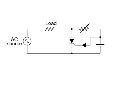

what about a 'phase controller' + resistor? SCR turns on after the line voltage (pos half cycle) is falling, when voltage drops below say 50 V, the SCR turns of for the remainder of the half cycle (about 10 % duty cycle or less). Adding a bit of silicon and a couple BJT's might be cheaper than a 1 kV capacitor. Don't forget an ordinary 250 VAC rated capacitor is going to be a bit too fragile, the fail mode is going to be a s/c. A 'X' rated cap (not a 'Y' rated) cap that's self-healing according to the data sheet, probably can't be relied on either.
I'd say go for a neon!
This sounds interesting, I did a quick google on SCRs, I'm guesing it would be something like the schematic i atached to this post. Maybe someone can help me a bit with this circuit.

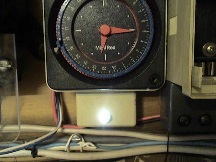

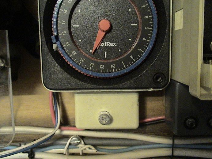

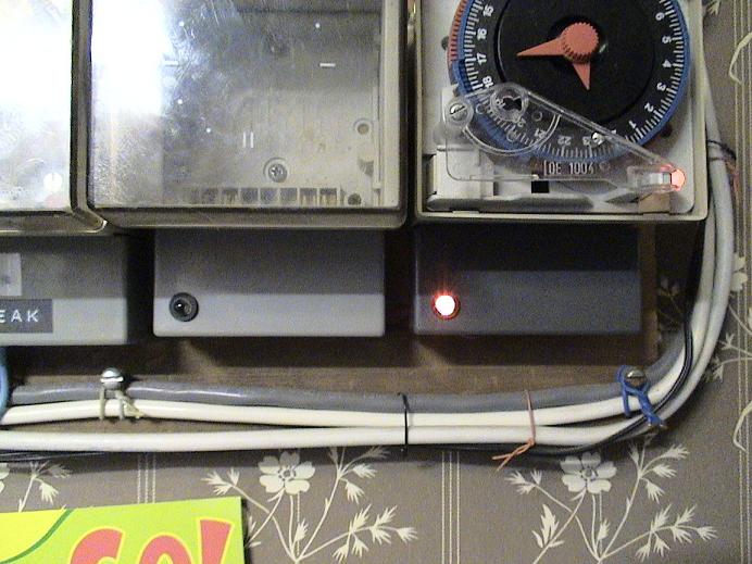

Attached photo's I just took today from my white (13000 MCAD) led with a 100k Ohm 1 Watt resistor on 230 Volts and 1N914 in anti parrallel ( no 1N4007 used here ).
LED current 2.3 mA.
power dissipation in R 0.53 Watts.
If space allowes use 2 x 47 k ohm 1 Watt in series to spread any heat developed.
The red led (5000 MCAD) is controlled via a 39k ohm resistor and a 1N4007 diode
For comparison the ON / OFF status is visualised.
