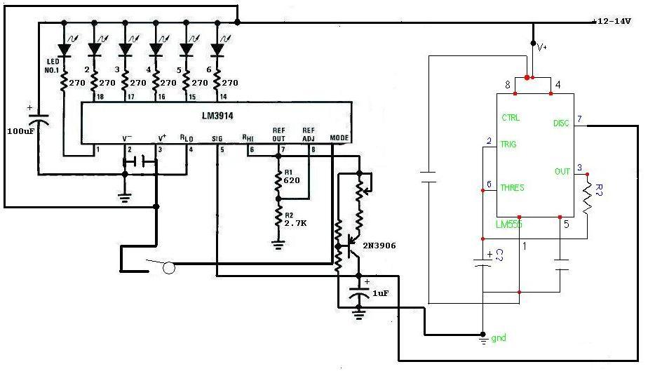

here is the updated

Hi Max,
Good, now you have a circuit that will basically scan the LEDs linearly when the power is applied. Only a few adjustments are needed:
1) The 1st scan will begin with a delay before the scan (longer than remaining scans) as the cap in the 555 circuit charges up to its operating voltage level. I am still working on a solution.
2) The reset time needs to be shortened with a diode and resistor or just a diode for the 555 because now the reset time equals the scan time (it will scan for 1 second then be off for 1 second, then scan again etc.)
Don't worry about the 555's pin 7 ratings, it is normally used to discharge the 555's timing cap which could be huge and is very stong. National Semi has a note about it in their datasheet that says the only problem is if it causes the 555 to get too hot. It will not even get warm by occasionally discharging your puny 1uF cap. Here's what they say:
Note 7: No protaction against excessive pin 7 current is necessary providing the package dissipation rating will not be exceeded.

To shorten reset time where would the resistor need to go and what value?

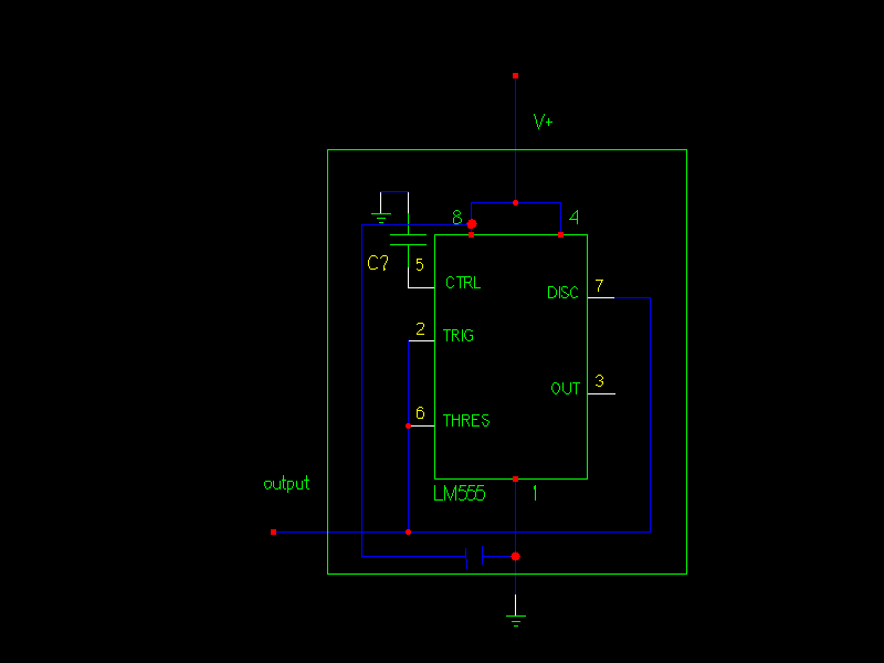

or would this work..

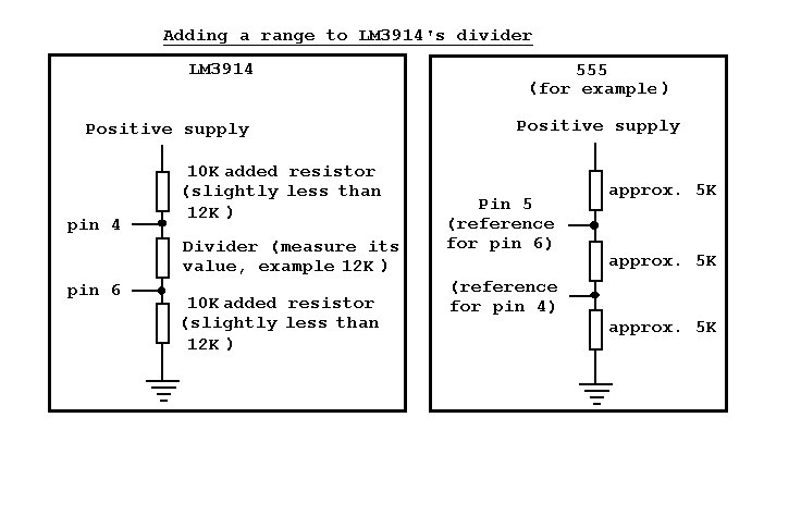

Hi Max,
That's a good idea that you have. There are many ways to connect a 555 but your newest one just might work well. It uses the 1uF cap and current source as the timing parts. The reset pin discharges the cap as fast as it can.
Its problem is that the LM3914's resistor divider between its pins 4 and 6 needs to be set to near the same voltage range as the divider in the 555. You can't simply connect them in parallel because the LM3914's divider resistance is too low. It would need to have its actual resistance measured with an ohmmeter then slightly lower value resistors added from pin 4 to ground and pin 6 to the positive supply. Like my attachment here.

Hi Max,
Clarification:
1) Of course the ICs have resistors inside. The LM3914 has a bunch of resistors between pins 4 and 6 that determine what input voltage lights its LEDs, and the 555 has resistors that determine the lowest and highest voltages of its timing cap.
2) Of course the circuit has changed from my original one, now the 1uF cap is the 555's timing cap, which never discharges to ground like it did in my circuit.
3) Inside the LM3914 between pins 4 and 6 are 10 resistors in series, that are used as a voltage divider. This voltage divider determines what input voltage turns on the LEDs. Now that the 1uF cap is used as the 555's timing cap, the cap's voltage will range from 1/3 of the supply voltage for its discharged voltage, to 2/3 of the supply voltage for its highest voltage. The 555's 1/3 and 2/3 of the supply voltage reference points are determined by a voltage divider of 3 resistors inside the 555 that are connected between the supply and ground.
4) We must duplicate the 555's voltage divider with another voltage divider for the LM3914 so that the 1st LED lights when the cap's voltage (input to the LM3914) is 1/3 of the supply voltage (the cap is discharged by the 555) and the 6th LED lights when the cap's voltage is a little less than 2/3 of the supply voltage (cap is at its highest voltage). It would be a lot easier to calculate voltages if the 555's cap voltage simply ranged from ground to a fixed voltage. It would also be a lot easier if you had 10 LEDs instead of only 6.
5) The 1st scan is longer because the cap must charge from zero volts (fully discharged from the circuit being unpowered) to 1/3 of the supply voltage before the timing actually begins. The LEDs will be off during that time.
6) You must measure the LM3914's voltage divider total resistance between pins 4 and 6 because the datasheet says that it could be anywhere from 8K to 17K ohms. We must know exactly what it is.
IC's are lousy at making accurate value resistors, but can make very accurate duplicates and ratios that are used in "normal" LM3914 and 555 circuits.
BTW, the emitter of the 2N3906 current source and its resistors must now connect to the supply voltage, instead of to the LM3914's pin 7. Pin 6 must also be disconnected from pin 7. Pin 4 must be disconnected from ground.
