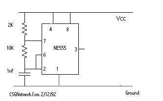

Windwalker, I have you some really bad advise. After reviewing your circuit and looking back over typical 555 circuits, what I should have said was to eliminate R1 (from the original circuit) and connect pin 7 of your timer to the junction of the two timing resistors, R3 and R2. The reason for this is that node should be 0V during discharge to insure the capacitor can drive towards 0V and thus low threshold ( Vcc/3) will always be gaurenteed. Sorry if I confused you. You may PM me if you want a better explaination. Also, you can add as many caps to C1 as you like.

Hi WindWalker,
Here is the drawing that I could not attach to the PM. Also, here is a great turtorial. **broken link removed**
