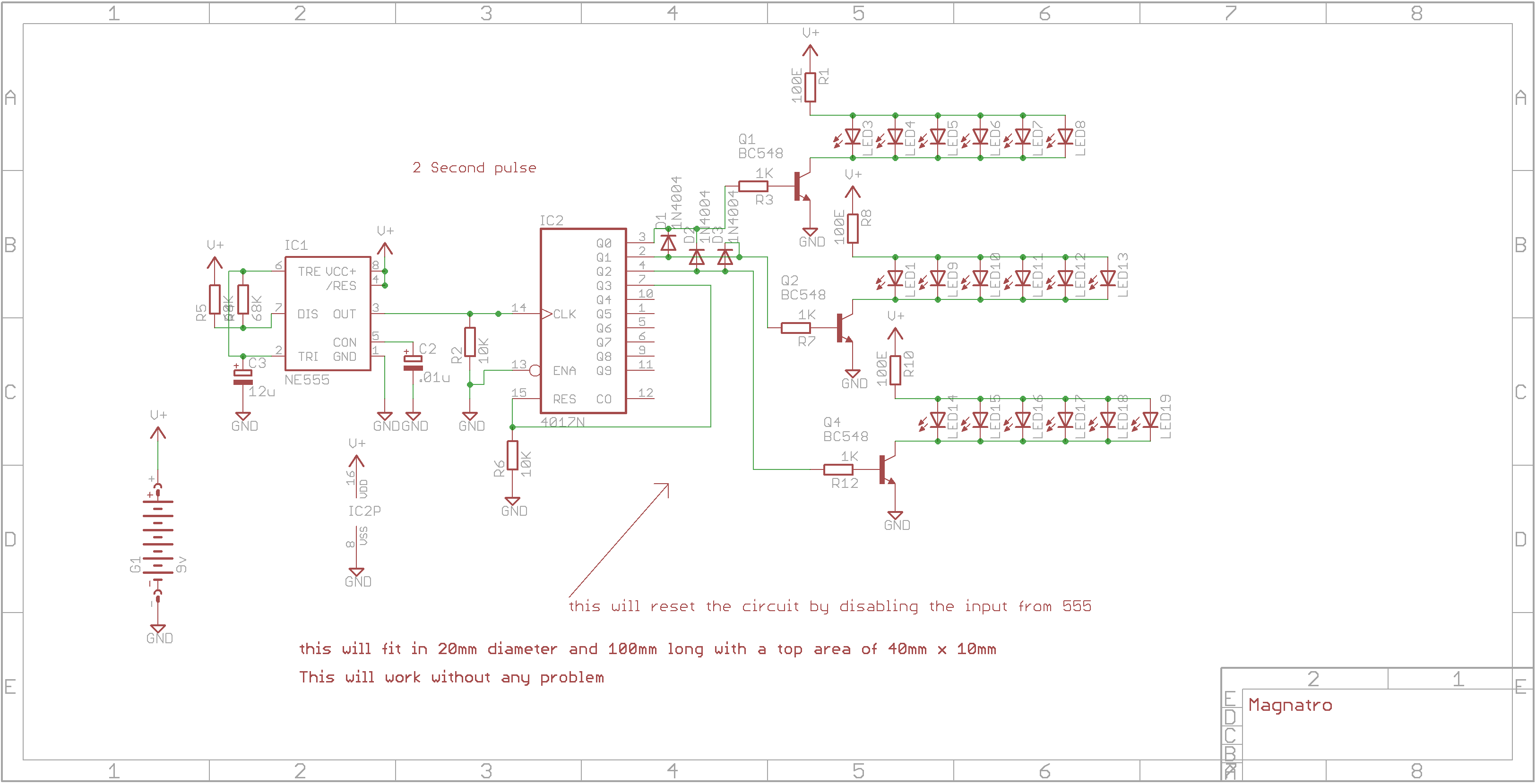

so i am trying to build a set of front turn signals for the front of my car, and this is the sequence i would like to duplicate
YouTube - 79 - 81 TA Sequential LEDs Taillight Upgrade Kit
i figure it shouldnt be this difficult, but then again ive never done this before
this is the schematic i drew up
is this correct and will this work?
also, how would i make the 555 timer work with the CMOS 4017?
The idea is OK. A 555 will drive a 4017 fine.
You need to connect the number 4 or 5 output of the 4017 to the reset line so that the off period isn't too long.
The transistors as shown will sink current so that the other side of the LEDs should be at +ve. Each LED needs a current limiter if it isn't built in.
If you want brakes lights as well you have a whole new level of complexity.
this may work !

Magnatro: that is exactly what i am looking for!

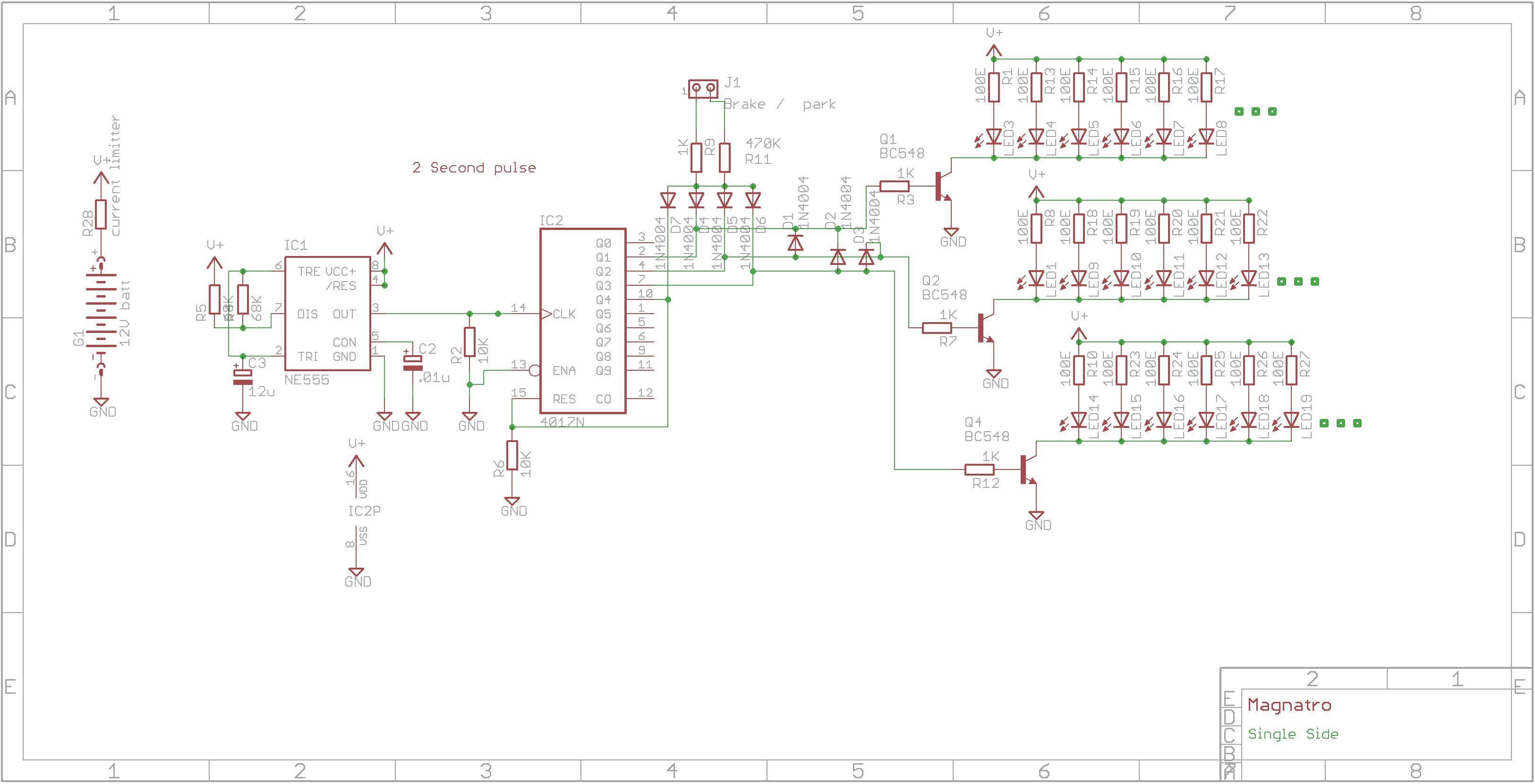

Diver300: this is only a rough schematic and i thought that would work but i wasn't sure, i am a total n00b on this stuff,
now, should i run a reset for the 555 as well?
oh and these will for the front of my car, so brake light circuit is needed

If you do not use serious transient suppression for the circuit, you will kill the 555, 4017, and the LED.
When you turn your headlamps off, when your windshield wiper motor starts and stops, fan motor, etc.. You can get upwards of 70v on the system.
This is called a LOAD DUMP. The inductance in the alternator is still full of operating current when a device is switched off. The larger the load, the larger the dump.
TVS to ground at input buss for each "blinker". (Use automotive rated TVSs)

ALSO, reverse battery protection. IF you have your hazard lights on, and give someone a jump start, a reversed battery connection can spell the end for your circuit.

You only get serious load dumps when the battery is missing, or is totally broken. When you turn off headlights or the heater or something, the alternator cannot respond quickly so the current that you have just stopped using ends up in the battery, for a second or so.
A battery that can hold more than 8 V when cranking the engine at 300 amps is only going to rise by 0.5 V or so when a 30 A surge is put into it.
You can also get short inductive spikes with the battery working fine, but they have a much shorter duration and a modest capacitor will absorb them.
However, none of that is a good reason not to have load dump protection. A load dump will almost certainly destroy 18 V rated ICs.
The battery is acting as a giant capacitor. It would still be good to have a suppression circuit just in case, but it's not really needed if the battery works fine.

I don't follow your calculations.
If there are 4 LEDs in series in each string, that gives about 8 V across the LEDs.
That leaves (13.8 - 8) = 5.8 V across the resistor.
The resistor is chosen to give 20 mA, so it is 5.8 / 0.02 = 290 Ω
If the voltage rises to 18.8 V, there is 10.8 V across the resistor. The current is then
10.8 / 290 = 37 mA
Even at 45 V, the voltage across the resistor is 37 V and the current is 127 mA. That might well damage the LEDs and I agree that load dump protection is a good idea. Also voltage fluctuations will get worse as the battery ages.
However, the big load dumps that are over 30 V and over 500 ms can't happen if the battery is capable of cranking the engine. Alternators are current limited by the inductance of their windings, and putting 50 - 100 A into a car battery won't increase the voltage more than a couple of volts.
A big load dump happens when a battery is low, and is being charged by the alternator, and the battery becomes disconnected. Then the current that was charging the battery has nowhere to go and the voltage can be very large.
