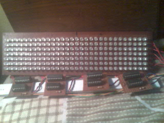

Here is another simple project that I have made for a taxi service.
Message "PILIYANDALA CABS + arrow" moving all 4 ways.
Here is a small video
YouTube - LED Sign Board 30X7
18 pin micro PIC 16F628A driving 210 LEDs (30X7) by the use of external drivers.
Code I cannot publish the code bcuz I'm cheating the client.Its simple to accomplish Sorry about that.
Pictures are very bad sorry about that.

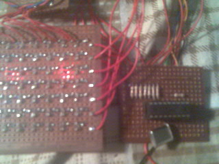

Actually there is no any row drivers (can you believe it?) Only the column drivers using ULN2803A.ULNs driving through Jonson counters.I did not use shift registers because I have plenty Jonson counters at home.
The secret is in the software & in that special LED.

So 7 columns per ULN2803 with a matching 74HC4017 driving rows?
Four pair of ULN2803 and 74HC4017? Isn't that only 28 columns?

Hi Mike I have 30 columns.From ULN 8 X 4 = 32 the last two outputs from the last ULN I kept free so 30.
From 4017 I took 8 outputs each. 8 X 4 = 32 the last four outputs from the last 4017 I kept free so 30.:)
I'm confused. I assumed you were driving rows with the 74HC4017's but now I realize there's no practical way to provide 30 bits of data onto the four ULN2803 inputs. How are you scanning this matrix? Schematic?

The row side driving from the uC through a resistor & the columns shifting from Jonson counters.
To provide CLOCK to Jonson counter I have taken 4 pins from PIC.
I could use 8 bit serial registers for this case but I had plenty Jonson counters at home.

Forget the row side simply shift the columns while inserting data to PORTB.

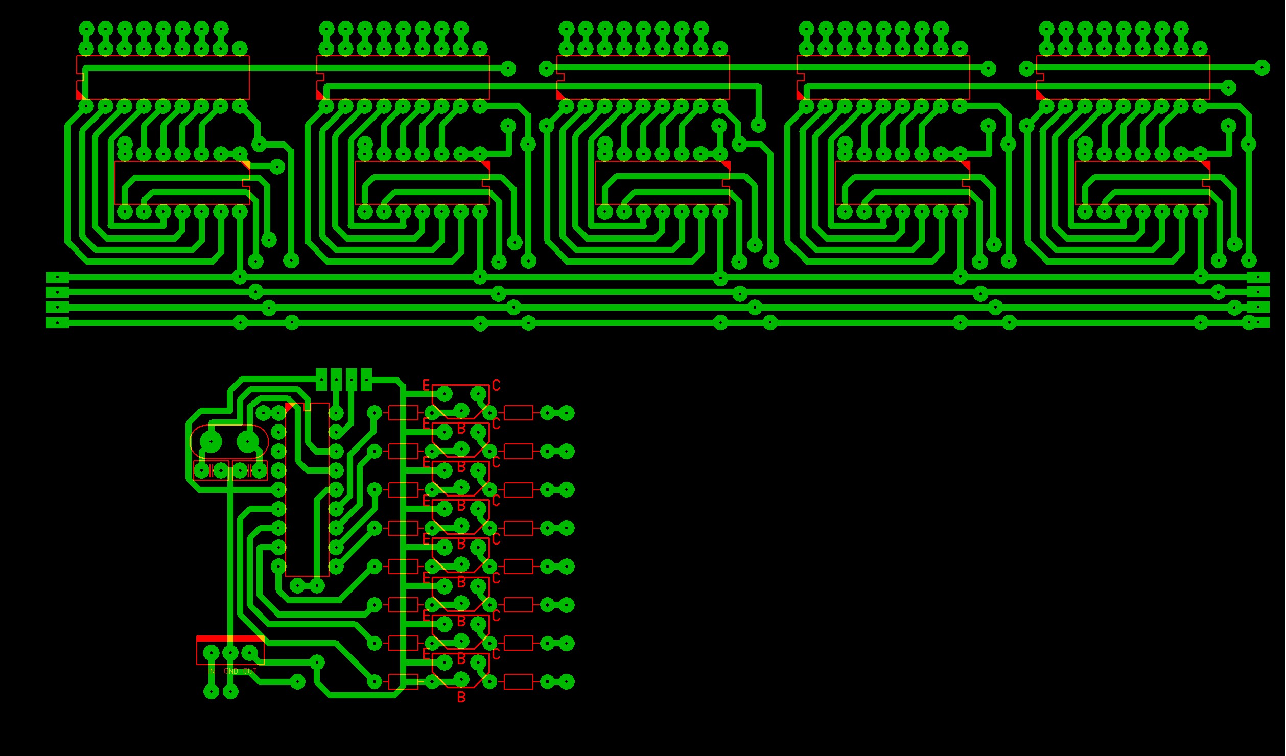

Ah yes that 74HC164 is one of my favorites & I have done some few boards using that.I have attached one of my PCB layout done in past.
I'd like to do a row scan to a large column displays.
Thanks for your information.
