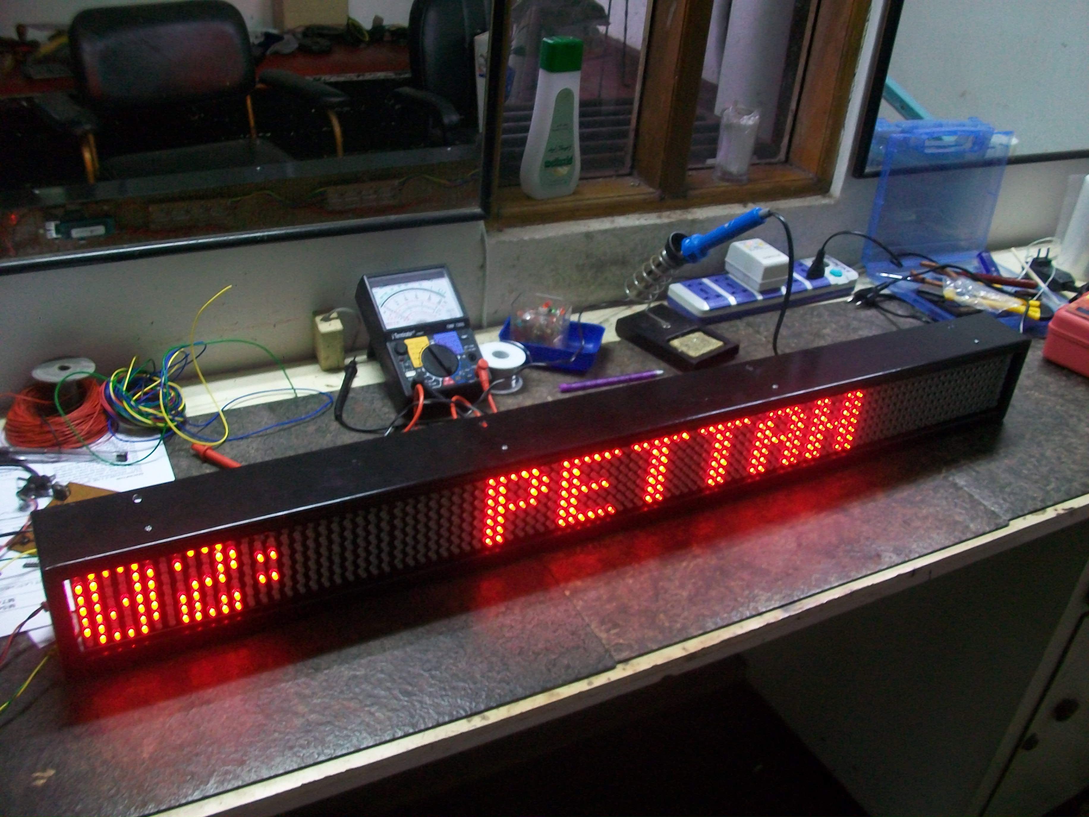

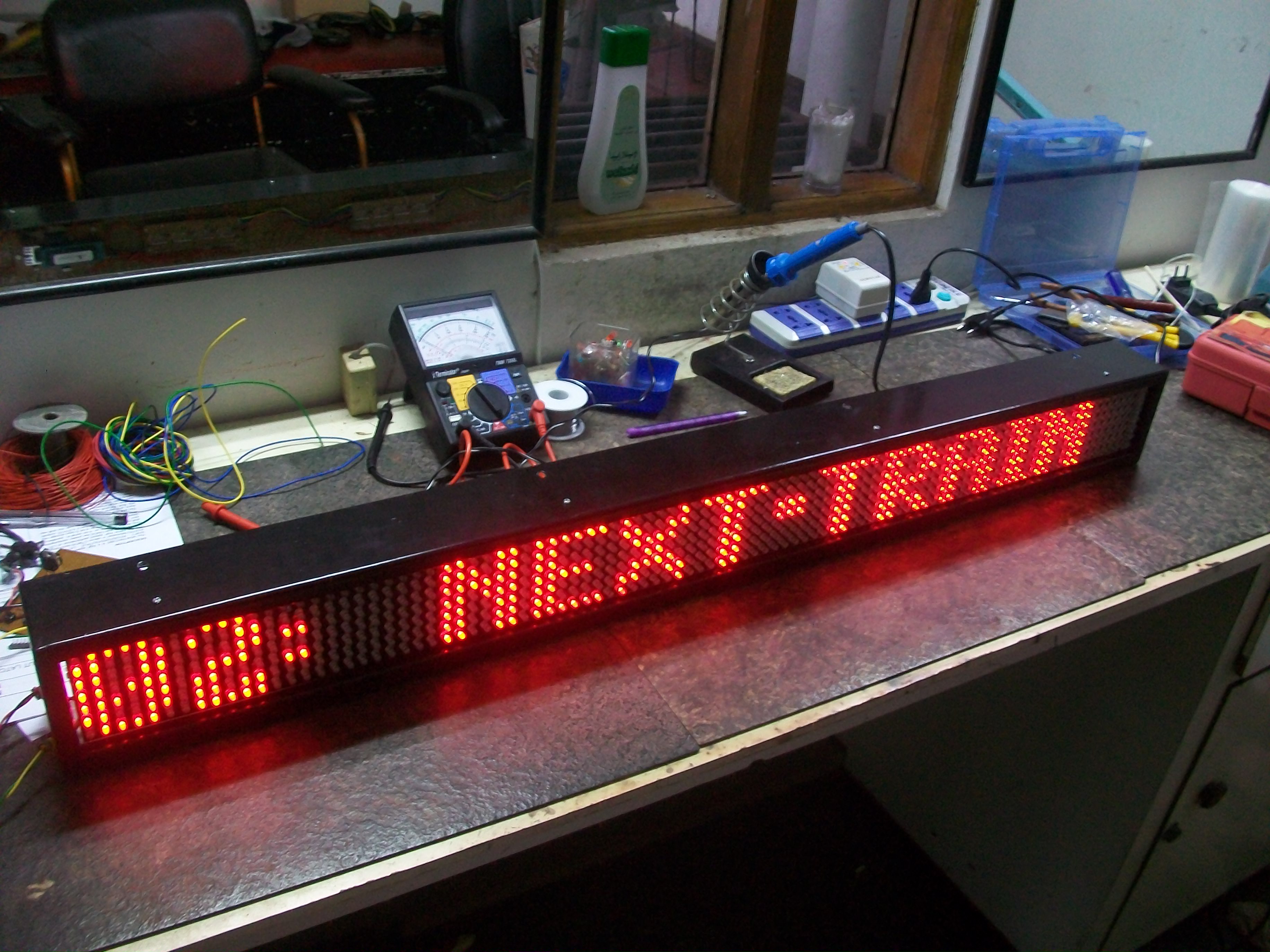

I'm a manufacture of signboards.There is a very competitive market over here.That's why I cannot give the full details & techniques I used.Sorry for that.
It doesn't matter how you driving the displays.It can be used shift registers,johnson counters etc.......Finally all you need is to smoothen the display.
Another one did recently.......it uses latch shift registers.
