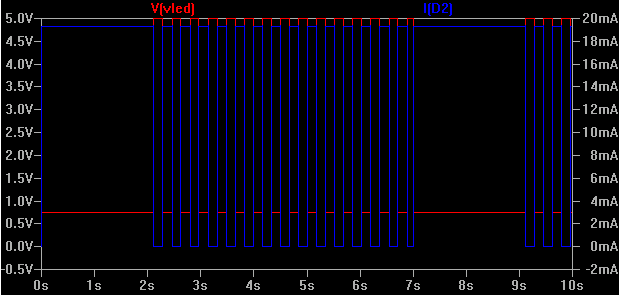

The simulation plays well when you click on a point to look at. I clicked on the output of the second 555 and it goes low 9 times then a pause then it goes low 9 times again then a pause again, over and over.

Nope. It runs once when you power it up, and then only starts a new cycle when you trigger it. Change .tran to 15, or 20, or whatever, and you'll see what I mean.

I run it and nothing happens until I click on a point to look at.
When I click on the output of the second 555 there is a 2 seconds pause then the output goes low 9 times then continues pulsing.

All is as it should be, I believe. It is also interesting to look at the timing capacitor voltage (C4) on the second 555.

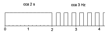

Hi, excuse me please for "my english". What I need you can see in attachement.
I do not use LTSpice, attach schematics as .jpg, gif, png, ... please.
Tnx

I expected to see a curved triangle wave on the capacitor.
SwCAD III thinks that the output of a 555 is rail-to-rail.

Do you want the circuit to do this only when power is turned on, or do you want to be able to start it with a trigger edge (or pulse)?

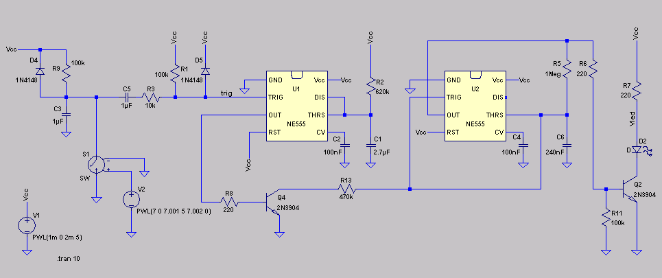

Also, you can safely ignore the .asc files (or you could download LTSpice; it's free from https://www.linear.com/designtools/software/). The one I posted was the same circuit as what you see in the PNG image that I also posted with it.
As Roff asked, does this need to work only once on power-up, or does it need to work on power-up and then whenever a trigger is received?
Also, what voltage does this need to work on? My circuit is assuming 5V; Roff's uses 12V. However, I think either should work with any voltage from 4.5V to 16V (those are the extreme edges of what a 555 will take)--just make sure that the current-limiting resistors are sized reasonably.
Anyway, here's a circuit that should do either. See the point where S1 goes to the left side of C5? All S1 is, is a normally-open switch to ground, and all it does is pull that point to ground for a brief time to retrigger the circuit. If you only need this to work on power-up, then get rid of C5, R3, R1, and D5, and it should work. (V2 is not a real thing in the real circuit; it just provides a quick voltage spike at 7 seconds to switch S1 to retrigger the circuit in the simulator.)
(Again to the wiser among us: please let risp73 and me know about any mistakes!)

Did you get a 404 Page Not Found error? The ')' at the end of the URL I posted messes up the link, I guess. The link again, with no '()':
Only once on power-on: PowerOn, 2 sec impuls, 3 Hz until PowerOff.
OK, then the last circuit I posted should do the trick; just remove the components I mentioned in my post.
Torben
