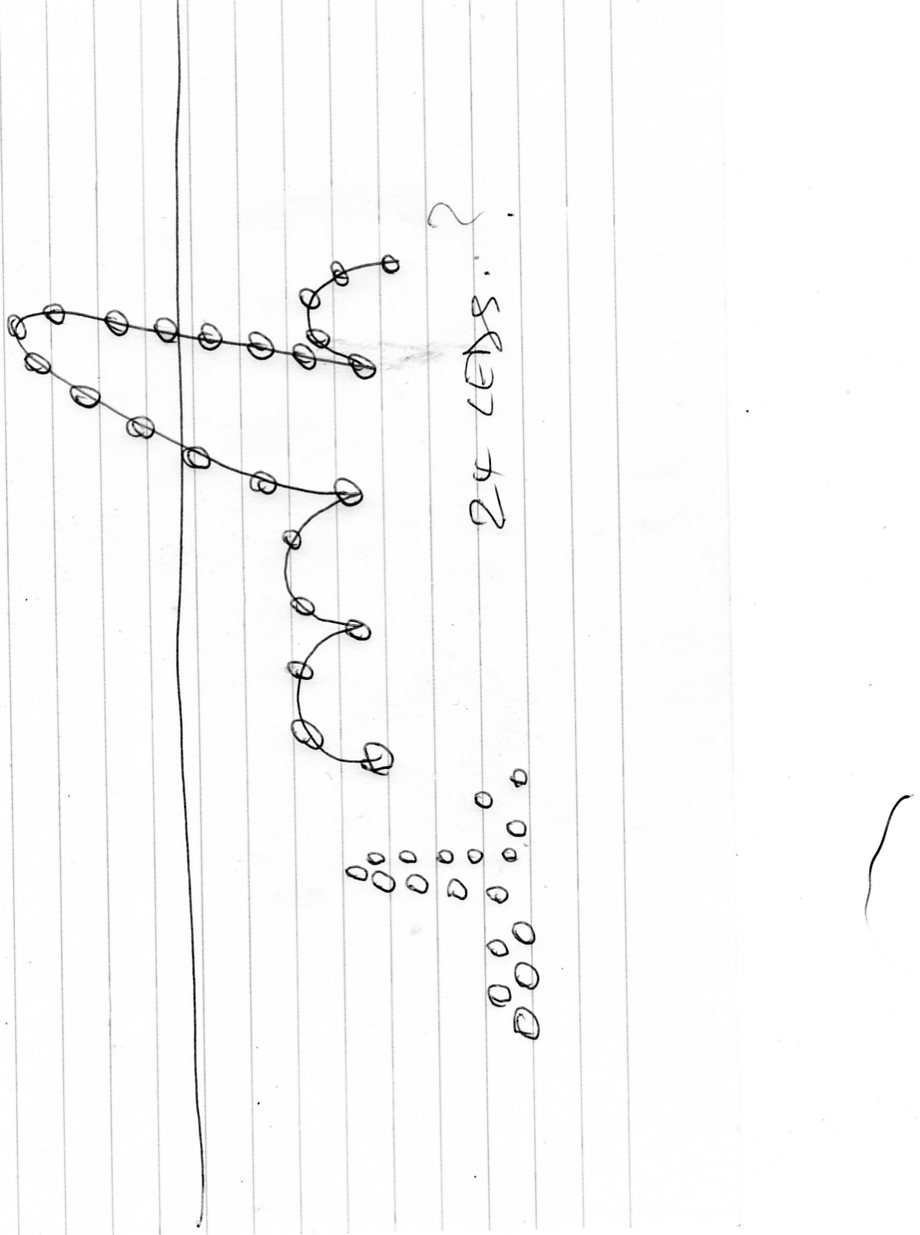

How to power up 24 ?
And have them flash of course
